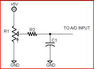

The potentiometer has three terminals to solder to. It sounds like you connected to only two of these?

Hook it up like this. The "clockwise" (CW) potentiometer pin should connect to 5V, and the CCW pin should connect to ground. The wiper goes to your ADC input pin on the microcontroller (uC). R2 and C1 are optional, but will help to steady the readings you get.
https://www.w9xt.com/img_1224968365_15498_1331504476.png
245775

You were right, I had to attach all three to the board and that fixed it. Thanks all
