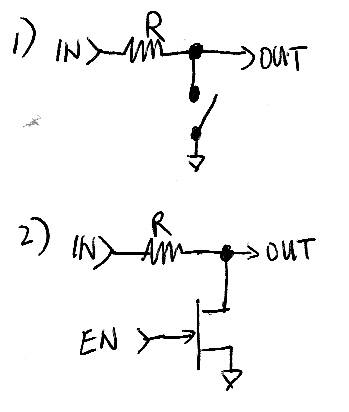

Hi, I am designing a channel switching all tube guitar amp that I have two channels and be able to switch between the two channels. For now, I am using mechanical relays for switching and it gives me a popping sound when I switch channel. So I want to design a muting circuit to mute out the signal to the power amp for a few mS to remove the "pop".
The circuit that drive the power amp are high impedance, it can be just a switch to short the output to ground to mute the signal. The difficult part is the signal from vacuum tube is quite large. it is +/-40V peak to peak. So most of the analog switch cannot handle it.
171790[/ATTACH]"]
1) above is what I want to do. I just need to find a device to serve as the switch. So far, I have been looking at solid state relays like this kind: http://www.digikey.com/product-detail/en/
TLP222A-2%28F%29/TLP222A-2F-ND/1823577
. Or http://www.mouser.com/catalog/specsheets/Toshiba-TLP172A.pdf.
Ideally, I would like a photoresistor type that it becomes over 5MΩ in dark and low impedance with light. But I have not seen anyone with build in LED. So I have to mechanically couple a light source to the photoresistor. If you know of any device like this, please give me a link.
I have seen muting circuit like drawing shown in 2). I don't understand how this would work. As I said, the problem is the signal is large signal and swing both polarity. Am I missing something that the FET only work in positive voltage?
If you have better suggestions, please let me know.
Thanks
Alan
Yeah, circuit #2 won't work for AC signals, at least not without several modifications.
Can you open the circuit instead of shorting it to ground? Do you still get a pop?
Actually, maybe a better idea -- stay with the shorting circuit and use a zero-crossing-synchronized optocoupler to do the shorting. Use a zero-crossing-detector circuit to ensure that when you short out the signal, it is near 0V so that there is no transient into your amp.

That's a opto coupled DIAC! I even download this data sheet. But if Y you type in zero-crossing-synchronized optocoupler on Yahoo and it did not even come up with anything!
Thanks, it's the name I don't get.

I have been looking at analog switches, but I need +/-40V, and more important, it's a tube amp. I only have +6V 3A, -60V 5mA unregulated DC voltage available. Also I have another question, if you look at page 1 of this schematic:http://schems.com/manu/soldano/soldano_50-100_hotrod.pdf

I think adding two signal transformers is too complicated. I think I am going for the mute right before the power amp.
I found out the name of the S1 and S2. It' called Vactrol.http://www.doepfer.de/a100_man/Vactrol.htm. I think ultimately, this is what I am looking for. No trigger timing and all, just a resistor switch where when I drive a current in, the resistance goes low. Then when you cut off the current, the resistance becomes very high.
Thanks for the suggestion.
Sorry I have not come back on this thread. I want to spend the time studying SCR, Triac and phototriac before I come back and talk. I am looking at this part:http://www.vishay.com/docs/83627/il410.pdf.
I want to confirm from reading the application notes and the data sheet.
1) Both the zero crossing and non zero crossing act like a short circuit ( almost) as long as I supply [itex]I_F\;\geq \;I_{FT}[/itex] where [itex]I_F[/itex] is the LED current, and [itex]I_{FT}[/itex] is the minimum trigger current. So if I apply the current to the LED, I short out the signal.
2) I should not use zero crossing phototriac because there is a delay after the start of the trigger signal until the zero crossing. I should use the non zero crossing as the device turns on as soon as you apply the current to the LED.
3) There are still some voltage develop across the triac, so there is a clipped signal going into the power amp even the triac is on.
I think all in all, the Vactrol should be a better choice as it is just a resistor that becomes low resistance when the LED is on, and high resistance when LED is off.
Triacs have forward voltage drop, the spec sheet you linked says on state voltage is 1.7 volts at 300 ma. They resemble a junction when conducting.
I would lean toward a linear device so you can taper its effect if need be.
You can experiment with a rheostat to see how much conduction you need in order to silence that 40 volt signal.
The zero crossing triac would be interesting in that it may not "Pop" - that's speculation i never tied it.
Triacs also have a minimum current, " holding current " above which they won't turn off until a zero crossing comes along, 65ua typ for the one you posted, 500 ua max. Conversely, below holding current they won't stay on in absence of a trigger signal.
And a similar "Latching current" below which they don't turn completely on, 500ua max for yours..
I've never seen one used in a signal string. They're not always symmetrical on opposite half cycles.
