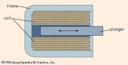

Hello, I have some problems with my solenoid calculations. I have spent many hours, on searching for Formulas, and answers, but exact answer I cannot find. I made 2 electromagnets, and then tried with solenoids.
Last solenoid was made with 120 m long wire, 0,3 mm, center diameter was 12 mm and 4 cm long. I achieved 0,5 A on 12V. But solenoid pull force was weak.
So here is my question: My goal is to make solenoid which can push iron bolt (center) with neodymium magnet with push force similar with when put two permament magnets with same poles.
I planned max 1A and 12 V. How can I make solenoid with max force with such parameters, and what kind of wire I need- 0.3, 0.5, 0.6, 0.7, how long, Is it even possible, to gain such solenoid force, with such parameters.
Thanks.

The ordinary pull force, for an iron bolt, can be estimated easily. The product of the current and the number of turns divided by the coil length gives the estimation of the magnetic field H inside the coil. The magnetic constant (1.26 microhenry/m) divided by 2 and multiplyed by the square of H gives the magnetic energy density inside the coil. Finally, the product of that energy density and the bolt cross section area gives the estimation of the magnetic pulling force (provided the end of the bolt is inside the coil).
As for pushing a permanent magnet, it's way more complicated, and the force must be much weaker...

My calculations: 1000 turns Current: 1A , length 0,04m
H=25000
Then : (0.00000126/2) * 25000^2 = 393,75
Then: 393,75* 0.00005527000m² = 0,021 ??
Is it correct, and is it kg or lb?? What I calculated?
It's 0.021 Newton
https://en.wikipedia.org/wiki/Newton_(unit)
Your energy density is 393.75 joule/cubic_meter ; when you multiply it by 0.000055 square_meter , it gives 0.021 joule/meter - and joule/meter is exactly Newton, the SI unit for force.
0.021 Newton is the force you need to lift a 2.14 gram weight - not very much...
To increase the force, one should use additional iron things in order to concentrate the magnetic energy near the bolt end, like here:
- the field H (not B ! ) is concentrated between the back iron plate and the internal end of the bolt (plunger). For example, it may be 4mm between them instead of your 40 mm - and then, the field is 10 times greater and the force is 100 times stronger.
View attachment 186520 View attachment 186521
I'm building a coil to test a solenoid and your comments helped a lot. Would you mind plugging this last comment about the distance from the plunger end to the back iron plate into the formula you mentioned earlier? E.g: the solenoid is still 4cm long, but the bolt is almost reaching the end of it (just 4mm to reach it) how to use this info in the formula? Thanks in advance.
