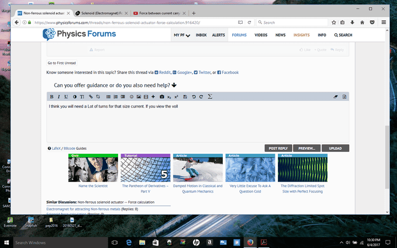

I think you will need a Lot of turns for that size current. The following video may help you with this issue.
