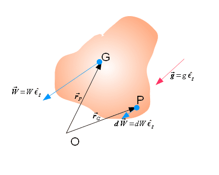

Consider the body shown below
Now, if G be the centre of gravity (or centre of any parallel uniformly distributed body force), then we define its position by equating the moment of total weight by moments of elemental weights about the same point i.e.
[tex]\vec{r_{G}}\times W \vec{\epsilon_{g}}=\int\int\int_V \vec{r_P} \times dW \vec{\epsilon_{g}}[/tex]
or
[tex]\left(\vec{r_{G}}-\frac{1}{W}\int\int\int_V \vec{r_P}dW\right) \times\vec{\epsilon_{g}}=0[/tex]
which explicitly gives,
[tex]\vec{r_{G}}=\frac{1}{W}\int\int\int_V \vec{r_P} dW + \lambda \vec{\epsilon_{g}}[/tex]
Now the question is: how to do away with the [tex]\lambda[/tex](an arbitrary number)
Seeing the question physically, this ambiguity in definition of comes from the transmissibility of force (from the point of view of moment).
This can be removed (mathematically, making [tex]\lambda=0[/tex]) by using the fact that centre of gravity has no bindings for orientation of the body.
So, how can I rotate the body and reduce the line of gravity (as defined above) to a point.

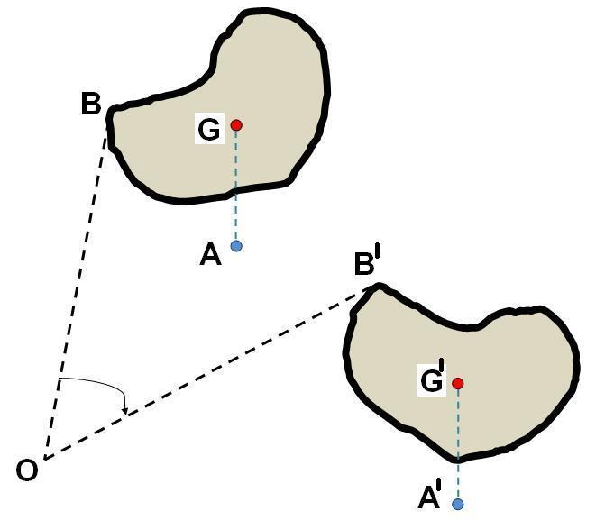

The physical approach actually makes one implicit assumption: G is "stick" on the body. See the figure. When we rotate the body about O, we can see that G doesn't move relatively to the body. On the other hand, another point A, which is vertically below (or above) G, is not "stick" to the body, and eventually, it is still at the same vertical position relative to G after we rotate the body.
Now we can easily see that the moment of gravitational force on the body about O is [tex]\vec{M_O}=\vec{OG}\times m\vec{g} = \vec{OA}\times m\vec{g}[/tex] provided that the gravitational field is uniform and points vertically upwards. In this case, while G corresponds to lambda=0, A corresponds to lambda = some value but 0!
You define CoG only via the total gravitational torque, therefore the final formula you deduce will except both G and A as solutions. Only when we include the other condition in the definition (i.e. G is "stick" on the body) can we eliminate lambda. This condition is already included in the definition of CoM.
I've thought of one way to eliminate lambda "mathematically" by using the other condition (I'm not sure if it's really math or not). This condition implies that G is independent from the gravity. If we switch the direction of gravity to another unit vector [tex]\hat{h}[/tex], the vector [tex]\vec{OG}[/tex] remains the same. By subtracting the 2 formulas, [tex]\lambda (\hat{\epsilon } - \hat{h})=0[/tex]. So lambda = 0.
Another way is to use a point B on the body. The condition implies if A satisfies the condition, the angles [tex][\vec{OB};\vec{BA}]=[\vec{OB'};\vec{B'A'}][/tex] = angle of rotation. There are 2 cases:
_ If A is G, it is solved.
_ If A is not G, then because GA // G'A' and BG is not parallel to B'G', the angle (BGA) is different from (B'G'A'). Thus, BA is different from B'A', plus the facts that the angle (ABG) can be expressed in terms of the lengths BA, BG, GA, and (A'B'G') is similar, GA=G'A', BG=B'G', we can conclude that (ABG) is different from (A'B'G'). Because:
[tex][\vec{OB};\vec{BA}]=[\vec{OB};\vec{BG}] + \hat{ABG}[/tex]
[tex][\vec{OB'};\vec{B'A'}]=[\vec{OB'};\vec{B'G'}] + \hat{A'B'G'}[/tex]
[tex][\vec{OB};\vec{BG}]=[\vec{OB'};\vec{B'G'}][/tex]
We shall see that: [tex][\vec{OB};\vec{BA}]\neq [\vec{OB'};\vec{B'A'}][/tex]
This means A doesn't satisfy the condition.
Just my 2 cents :wink:

The game is not over!
G 'sticks' to the body is an unwarranted assumption. (Why?)
When we rotate the body we do not know whether the lines of forces (new and old) intersect, that is what we have to check. In other words we do not know, at least before doing the analysis, that whether the CoG exists or not. If it exists it will definitely 'stick'. But assuming it to be fixed when we do not know whether it exists or not (no one can say this from the equations I gave earlier) seems to be incorrect!
See the corrected figure below.
And as of cents.....first find their CoG:smile:.
