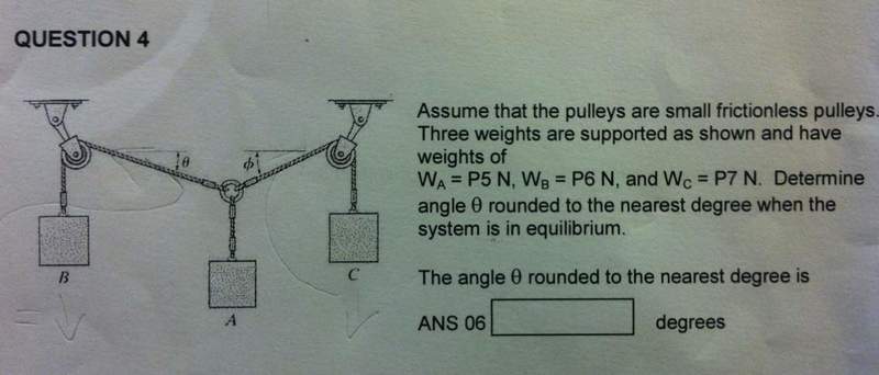

Thanks for the quick reply.
I have attached the original physics question,
the parameters were given to me online, which are
Weight of A= 144N
Weight of B = 229N
weight of C = 202N

The right side of your second equation in the previous post is not zero. The vertical components of the tensions in the strings must balance the weight of A.
ehild
Thank you so much Ehild for your help :), i completely missed that.
Can you solve the problem now?
ehild
sadly not, I had high hopes, and gave it a shot. But i still don't know how to solve a simultaneous equation with the uknowns as the angles..
It is always very useful to move the terms with different angles on the different sides of the equation, square both sides, then add up the equations, and replacing sin()2 +cos()2=1
