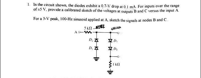

A picture of the problem is provided in the attachment
there is no special relations except
I= Is x e^(vd/Vt)

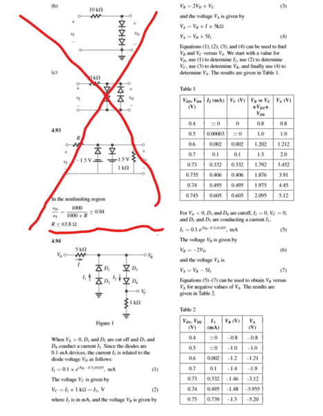

i have a solution for from the solution manual but i do not understand it
like the I2 equation i don't get reasonable values when i substitute VD for any value > 1 or even 1
i attached the solution that i do not understand

i am sorry for the fuzzy picture. it is the pic of the solution which i don't understand. leave it alone
the first pic is about the question and it is clear
what i know about the problem: that the diodes have 0.7 voltage each as VD
diodes 3 and 4 only will conduct if the input voltage VA is positive. in this case there will be an output voltage at both C and B ( C is that output before the 1k ohm R )
for a negative voltage diodes 1 and 2 only will conduct and for this case there will be output voltage at B only
how much?
this is what i am asking for
note: these diodes are working as voltage regulators
The output voltage at B is unable to go more negative than -2V. If you try to send it more negative than this by giving A a large negative voltage, then increased current flows through the 5k resistor via the diodes, and this results in more voltage dropped across the 5k resistor—leaving still 2V across the pair of diodes.
This assumes the diodes are within their current rating and don't overheat or burn out, and the voltage across each when conducting can be approximated as 1V.
