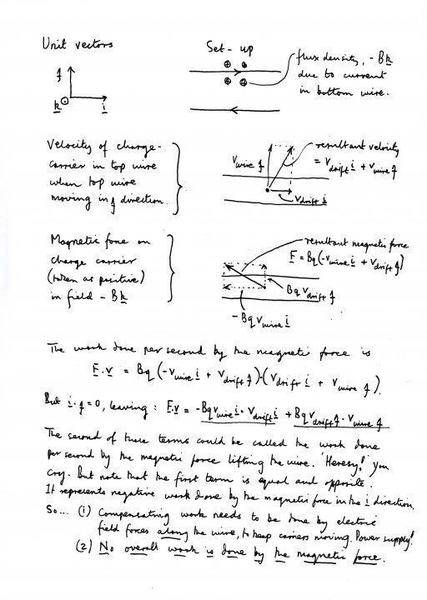

You asked where the work came from. Griffiths explains it's the power supply that maintains the current.
A fair point: upward magnetic forces on charge carriers in top wire are balanced by downward electric forces from the rest of the wire due to imbalance in charge distribution, and it is the Newton 3 upward electric force on the rest of the wire which actually lifts the wire. So it's the electric force which does work lifting the wire.
This is doubtless true, but is a bit like saying: I pull a trolley along with a gloved hand, so it's not me but my glove that is doing work on the trolley.
What I do find satisfying is an explanation is in terms of the magnetic force components on each charge carrier parallel to the wire and perpendicular to the wire, as explained in my post 12. I'll show the forces on a diagram, and try and make my case clearly below.
Handwritten notes on a physics derivation: unit vectors, a set-up with a current-carrying wire and flux density -Bk, velocity diagrams, and the work-done equations F.v = Bq(-v_wire i + v_drift j)(v_drift i + v_wire j) and F.v = -Bq v_wire i + Bq v_drift j.
What I do find satisfying is an explanation is in terms of the magnetic force components on each charge carrier parallel to the wire and perpendicular to the wire, as explained in my post 12. I'll show the forces on a diagram, and try and make my case clearly below.View attachment 87798 argument from there.
OK i find ur points very valid so i drawing conclusions
As the magnetic field varies with time due to movement of wire upwards , an induced electric field(non conservative) develops inside the wire between the drifting electrons and the protons.
So the work is lifting the wire up is being done by electric force and not the magnetic force .
Any more points i need to add?
Good. And it's good that, according to BvU, Griffiths also attributes the work done to the power supply.

I don't quite agree with you here. It's not the magnetic field varying with time that induces the back-emf, or, equivalently that causes the 'backward' forces along the wire on the charge carriers. Rather, it's that the wire, and therefore its charge carriers, are moving through a magnetic field, and therefore experiencing a Magnetic Lorentz force, [itex]q \mathbf{v} \times \mathbf{B}[/itex]. This can, if one wishes, be regarded as electromagnetic induction by means of flux cutting, but there's no need to use the terminology of e-m induction: the argument can all be carried through in terms of forces and work, as I did in post 12 and the handwritten continuation.
Note that all this is about forces due to the magnetic field. There is also an electric field, which exerts a force to the right on the charge carriers, opposing the magnetic force to the left, and which is set up by the power supply. This ultimately does the work. [Note that the force between electrons and ions is yet another force due to an electric field.]

magnetic force to the left?
Yes, to the left, as in the hand-drawn diagram. This is the component of the magnetic force which arises from the upward motion of the wire. The other (upward) force component arises from the drift velocity of the charge-carriers along the wire.

It just occurred to me that my argument can be summed up like this:
A (cartesian) component of a magnetic force can do positive work, provided that the sum of the work done by all three components is zero.
The implies that if one component does positive work, at least one of the other two does negative work.
In the case we're considering, the component of force in the [itex]\mathbf{k}[/itex] direction is zero.
