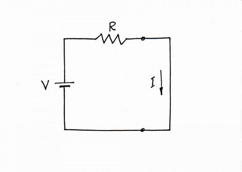

i have just remembered something, i understand the consistency principle and i am totally convinced that number 3 is wrong because the wire must have the current 0 and I at the same time, but regarding number 4 i think the concept of infinity has a rule, now we have short circuit saying voltage is zero, but this saying is based on the resistance being zero so multiplying it by current gives zero, but this in case current has a real value, if current is infinite we can't say voltage is zero, like in open circuit, we have zero current in open circuit, but we can't say voltage drop is zero, because resistance is infinite, so what do you see ?
  • #33

thirdly regarding erroneous equations : so why in open circuit connected to voltage source we have alike set of equations but considered valid, in open circuit : equation for the source tells that voltage difference is V, and equation for the open circuit tells that same voltage difference is I*R = 0*R or I*(infinite resistance), so R is V/0 = infinity or I is V/infinity = 0
  • #40
let me rephrase my point in a way acceptable by all, for this simplest circuit :
I = lim(R→0) V/R = infinity, meaning that as R approaches zero I approaches infinity, this is represented by this curve :
the division by zero is actually a limit, the R approaches zero but never reaches it, my mistake was getting a circuit with 0 resistance and then evaluating a limit of R approaching zero, the corresponding resistance to this limit should approach zero not equal zero.

There is no R in the equation for the wire. If ##V_a## is the voltage on one terminal of the voltage source and ##V_b## is the voltage on the other side then the equation for the voltage source is ##V_a-V_b=V## and the equation for the wire is ##V_a-V_b=0##. There is no R involved and the equations are inconsistent and no value of I can be determined.
This is a good approach. When an ideal wire seems to make something nonsensical, then replace it with a resistor and take a limit as the resistor goes to zero. Often you will find that the new circuit has a consistent set of equations and sensible limiting behavior.
