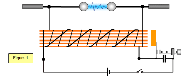

Can you post a link to a typical circuit that was used?
Even if there is a capacitor on the output of the coil and switch, the cap will mainly limit the peak voltage that is reached after the switch is opened. The energy stored in the coil current gets converted to the energy stored in the cap at the peak of the voltage spike (minus any energy lost in generating the x-rays, etc.).
http://www.schoolphysics.co.uk/age1...ic induction/text/Induction_coil/images/1.png
I thought that the capacitor in the figure you gave (right under the interrupter) caused the coil to produce a burst of AC.

I probably should have found a better diagram. Do you have one?

Not sure about it, Kathy, I will investigate. I thought the capacitor was proportioned so it just speed up the switch action and there was a uni-directional pulse on the secondary. Like a motor car ignition, it is DC. Anyway, I think X-ray tubes are sometimes operated on raw AC as they can obviously self-rectify if wanted, so the waveform out of the induction coil does not really matter.

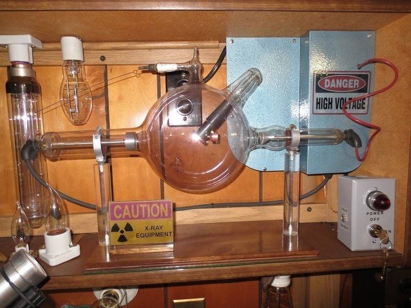

Old rectifier tubes were very similar to old x-ray tubes. Here's a cool collectors site.
From the "Victor" cold cathode valve description:
Because of the important difference in the surface size of the electrodes, the current passes much more easily in one direction than in the opposite one.
... use of two valves, connected in series in opposite directions, between the induction coil and the x-ray tube as shown below (right) was highly recommended.
Edit: BTW A couple pics of my Victor x-ray tube; on and off.

Thank you so much! And your Victor x-ray machine is amazing
