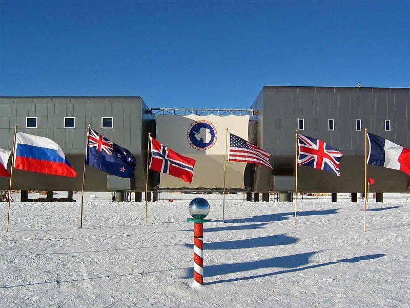

sandersr
Stephanus said:
Good, at least there are US, UK, France, Denmark? Russia? Australia?
