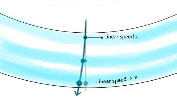

Hello boneh3ad. What troubles me is the cause of Coriolis, the gradient also but not so much. Let me give you an example.
In the image bellow we assume that we have our centrifugal full of a liquid let's say water.
The water is completely stable at start. Stable requires particles to move faster on a greater radius to follow exactly the walls (of the construct).
Then we test a big "particle" let's say a ball that can sink.
The ball has some specific linear speed and kinetic energy at the start of sink.
While sinking ball hits faster moving particles.
The ball cannot instantly gain that new linear speed required at this new radius..
The ball gains the speed after a period of time. But while faster particles exchanged that energy, they lost kinetic energy.
So the fast current became already slower.I see the ball as one of the particles. So any movement downwards can cause that.
Faster particles on the other hand that happen to go up will be pushed to slow down .
The water can only be re-stabilized again (gain correct speeds) after friction with the walls of the construct.
Maybe liquids will tend to have a slow flow against the direction of spinning. That`s what i assume.. at least.
