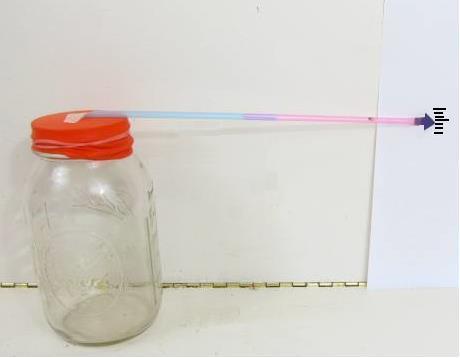

Here's an experiment you can do at home
Make your own barometer and note the changes in air pressure
Take a glass jar and stretch a sheet of rubber across the opening and rubber band or tape it so it seals the jar. Take a drinking straw and glue it to the rubber top and so it sticks out past the edge of the jar for some inches
set it against a cardboard backing and have a line marked off in say 1/4 inch increments and watch how the end of the straw changes its position as the weather changes
cheers
Dave

yup thanks a lot for answering my questions :D i will do it once i get the rubber :D thanks a lot again
