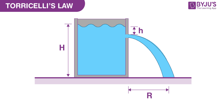

We can derive it by using Bernoulli's equation ##p_0+h_0\rho g+\frac12 \rho {v_0}^2=p_1+h_1\rho g+\frac12 \rho {v_1}^2##, where ##v_0=0## is a velocity of a water surface and ##h_0## is its height. ##h_1## is a height of the outlet above the bottom of a tank the water is in. I am confused about the assumption that both pressures are the same, that ##p_0=p_1## is the atmospheric pressure.
I understand that at the water level, the pressure is equal to the atmospheric one, but why is the pressure at the outlet also atmospheric? Why it isn't a hystrostatic pressure plus the atmospheric (##p_1=(h_0-h_1)\rho g +p_0##)? Because there is a certain amount of water above the outlet.
The second way of deriving the law is that we can imagine it as if we "teleported" a certain amount of water from the water level and gave it a kinetic energy at the outlet. So then ##mgh_1=mgh_0+\frac 12 mv^2##. Why can I imagine it this way? I intuitivelly feel that the water will have such energy, but I don't understand that explanation.
The outlet pressure is atmospheric (by definition) for discharge into the atmosphere. You're probably just going to have to make peace with that until it makes sense. What else could it be?

The outlet jet is surrounded only by atmosphere. I think in reality there is very small transitional zone where the pressure changes from what it is inside the pipe to outside- practically a step change though because the pressure change is communicated at the speed of sound in the jet fluid, and that is usually significantly faster than the speed of the fluid jet itself.

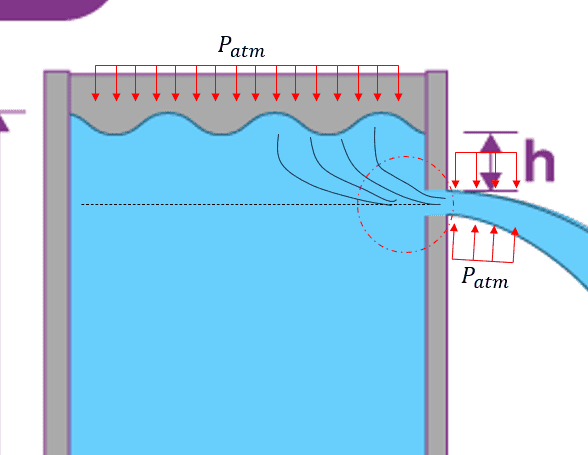

But when I have something like this, from one side, there is an air with its atmospheric pressure, but from the other side, there is a water with its hydrostatic pressure. Or not? Why?
Consider mass of water ##dm## that is instantaneously filling the space of the hole that has area ##A##. On one side you have hydrostatic pressure ##p_h## and other side you have atmospheric pressure ##p_a##. The pressure difference is ##\Delta p=(p_h-p_a)=\rho gh## which means that there is a net force ##F_{\text{net}}=\Delta p~A## on ##dm## which accelerates it out of the hole. How could the water move out of the hole without a pressure difference and hence a force to drive it out?

The streamlines are converging in this red circle. So you don't really have ## P = \rho g h ## everywhere along the black dotted line, the velocity of a particle along a streamline is increasing as it approaches the outlet, the pressure is dropping. Also the hole in the wall has some diameter, and the pressure varies over its surface. Inside the wall the pressure is still higher than atmospheric and over some very short distance outside the wall it drops to atmospheric. I hope it's clear that Bernoulli's is a derived simplification of reality.

That streamlines are interesting. Does it mean that the water is leaving the tank by flowing from the water level? Because I thought that the water leaving it is water at the height ##h_1##, not ##h_0##.

If water is moving from the outlet, water is moving in from elsewhere to takes its place, and that water, is being replaced, etc... The criterion that ##V## at the surface is ##0## is an approximation. For steady flow (without viscosity - another basically unphysical assumption), Bernoulli's is valid along a streamline, but what's happening on that streamline (the convenient one we force into existence to make some calculations) is not really characterizing what all the fluid particles on all the streamlines are actually doing.

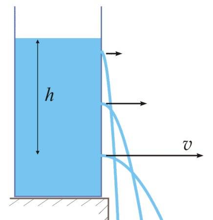

Lotto said:
That is the distance of the outlet from the bottom. ##h_0## is the distance of the water level from the bottom.
Taking the bottom of the tank as reference may lead to confusion.
The velocity at which the fluid is horizontally leaving the tank is independent from the depth.
All it matters is how much column of fluid exists above each orifice.
