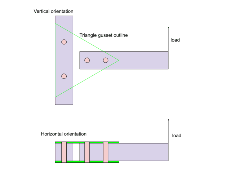

Could you show us a drawing of beam and gussets?

Sure, here is what i mean (no welding, just bolts/screws+plates):
Diagram comparing a vertical orientation with a triangle gusset outline joining a plate to a bar with two bolts, against a horizontal orientation with two green plates clamped by three pink bolts, both with a load arrow at the free end.
There is no simple "one answer fits all" answer to your question. You need to analyze the entire joint. A simplified outline is as follows for the vertical orientation:
1) Bending strength of the horizontal beam at the point of highest moment.
2) The horizontal beam bolted joint. Note that this involves multiple calculations for shear, crushing, tensile failure, slippage, etc.
3) The gusset at the point of highest stress.
4) Bending strength of the vertical beam at the point of highest moment.
5) The vertical beam bolted joint. Note that this involves multiple calculations for gusset shear, bolt shear, local crushing, tensile failure, slippage, etc.
The strength of the assembly is whichever of the above is the weakest. A similar analysis applies to the horizontal orientation.
A complete description of how to do all of this would involve writing a book. Fortunately, there are multiple books available that do exactly that. Search Amazon books for structural steel design to find a selection.

Sorry, I thought my question was clear. I am only concerned with the gusset (point #3). The other points are more straightforward. Also, I only asked about the horizontal orientation in my original question. I only show the vertical just to clarify what I mean by horizontal orientation.

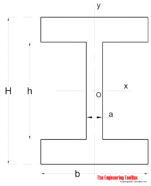

If I understood you correctly, you would model your gussets as an I-beam where a = 0:
Cross-section diagram of a symmetric I-beam with labelled dimensions H (overall height), h (inner web height), b (flange width), a (web thickness), and centroid axes x and y marked at O.
Ix = (a h3 / 12) + (b / 12) (H3 - h3)
Iy = (a3 h / 12) + (b3 / 12) (H - h)
The width b of your "I-beam" is the smallest value within the gap between your bolted beams.
Ix is when they are placed horizontally and Iy is when they are placed vertically.

Thanks @jack action, this is what I hoped it would be, but it seems too good to be true. The reason I say that is that the gap between the beams containing only gusset cross section differs from the I-beam in that it is missing the vertical center flange / web. So is it really as strong as an I-beam, or is it as weak as 2 individual thin plates, or something in between?
Where two narrow members are joined at right angles, the size and the distance between the pairs of bolts that handle the moment is limited. Using bigger bolts would reduce the section of the members, and so weakens the structure. It is necessary to use smaller bolts, with greater separation, on the neutral axis of the members to be joined.
There are two simple ways to maintain the strength, while handling the moment.
1. Use a diagonal or asymmetric triangle with three bolts. That joint does not keep members co-planar, so is uneven, and must be deformed and stressed during assembly.
2. Use a symmetric gusset with four bolts. That makes a better flat base, while keeping the structural members co-planar.

jack action said:
Whether you look at it as 2 plates or an I-beam with no web, the geometry is exactly the same. If the plates are thin, it is weak, and if they are thick, it is stronger.So, used horizontally, it is an I-beam and when used vertically, it is an H-beam (the "transverse direction" in the previous quote).
Unfortunately, that is incorrect. There must be a transfer of longitudinal shear through the section, and in the case of separated plates, that cannot happen. In the I-beam it does happen. If the two thin plates are indeed to be treated separately (this is part of my question), you must use the area moment of inertia calculation for thin/short rectangles (bh^3/12), and not that of the I-beam.

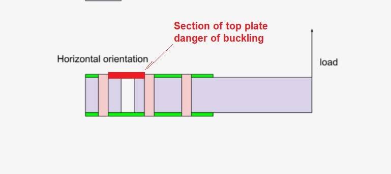

lordvon said:
the gusset plates could be acting as mere thin plates (that might buckle) in bending, which would be by far the greatest weak point
Then the gusset plate thickness selected is clearly insufficient for that application.

well, the question really is how do you calculate the stress in these plates (or geometric instability / buckling limit). so that one can determine the right size/thickness of plate. we can be certain though that the gusset plates cannot be treated as an i-beam.
There is still shear going through the plates. It is just not very efficient.
As I said in my previous post:
where a = 0, thus Ix = (b / 12) (H3 - h3).
The geometry is the same.

When you say "do not require a web" are you saying the gussets arent the weak point? If not, wouldn't the web (if it could somehow be applied) make the strength of the joint more similar to the beam?
jack action said:
From post #6, h is not the thickness of the plates but the distance between them. The shear goes through a section that is (H - h) in height, which is the thickness of the 2 plates.
oh, my mistake, I meant thickness of one plate. but, my point still stands. e.g. (H^3-h^3) is much greater than 2 * thickness^3.

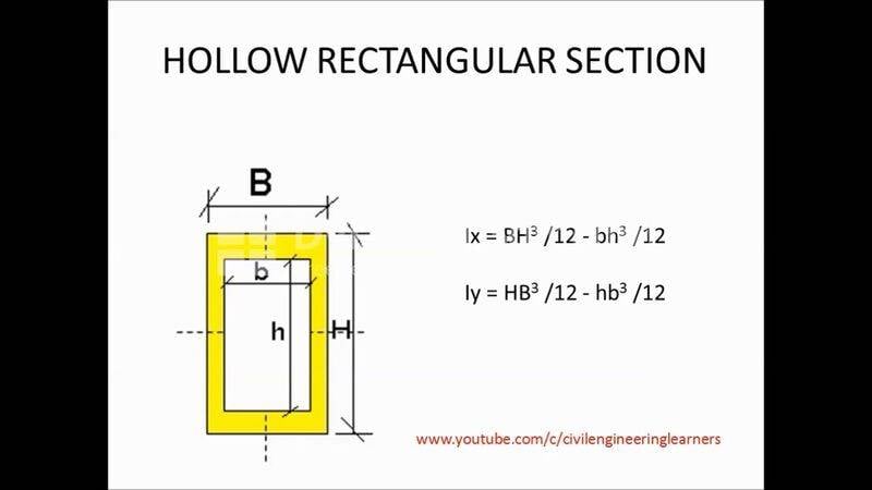

jack action said:
It's the area bh³ subtracted from the area bH³, like for a hollow rectangle, except the inner "empty" rectangle is the same width as the outside rectangle.
haha, i was going to cite this example to convince you of the opposite, but somehow you are further convinced of what i believe is the incorrect view. why dont you try this out in an experiment? Get a tube, then get 2 plates and set them apart a distance such that the formula you are using gives an equal area moment of inertia. Which one fails much earlier?
