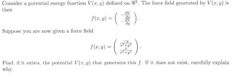

notojosh Messages 9 Reaction score 0 Thread starter May 19, 2011 #1 I've no idea where I need to start. please help me! Attachments forum.jpg 15.9 KB · Views: 509
Andrew Mason Science Advisor Homework Helper Messages 7,836 Reaction score 532 May 19, 2011 #2 Since: [tex]f(x,y) = (\frac{\partial V}{\partial x}, \frac{\partial V}{\partial y})[/tex] then: [tex]dV = dV_x + dV_y = f(x,y) dx + f(x,y) dy[/tex] Can you integrate to find V? AM

notojosh Messages 9 Reaction score 0 May 20, 2011 #3 I don't know because f(x,y) is not defined. Can you give me more tips? Josh
Pyrrhus Homework Helper Messages 2,181 Reaction score 0 May 20, 2011 #4 notojosh said: I don't know because f(x,y) is not defined. Can you give me more tips? Josh It is not defined? look at your own picture!

notojosh Messages 9 Reaction score 0 May 20, 2011 #5 oops... Ok I found out V=-tan^(-1)(x/y)+tan^(-1)(y/x)+C where C is arbirary constants.. And.. now what? should I take a differentiate V as the upper equation says so is that basically asking two equations are commute? ...
