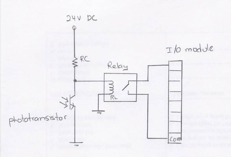

Can anyone help me to check and calculate the resistance required?I am confused on the calculation part.
For example,the specification of a phototransistor is given below:
Vceo = 45v
Veco = 6v
Vcbo = not in datasheet
Vebo = not in datasheet
Power dissipation = 75 mW
Ic = 10 mA (condition Vce = 5V) (typical)
Ic = 2.5mA min
Ic = not stated for max
Dark current, Iceo = 2 nA
Vce (sat) = 0.2 V (condition Ic = 1mA)
The relay coil resistance = 393 ohms
Calculation of the Rc:
This is the way which I calculated (most likely wrong);
When phototransistor is off (no light);
Since we need 12 V to energize the coil,
Ic = V coil/Resistance of relay
= 12/393
= 30.5mA
When Voltage across coil = 12 V,
then Vc = 12V
Hence Rc = Vc/Ic
= 12V/30.5mA
= 393 ohms
If I am to disconnect the relay, and when phototransistor on;
Given Ic = 10 mA and Vce = 5v in datasheet;
Vcc = IcRc + Vce
Rc = (Vcc - Vce)/Ic
= 1900 ohms
I am abit confused here on the calculation.If I am to select 1900 ohms for Rc,I will surely not get 12V dc to energize the relay when phototransistor is off since the relay coil resistance is so small.I think something is wrong the way I used the datasheet.Can anyone correct me please.

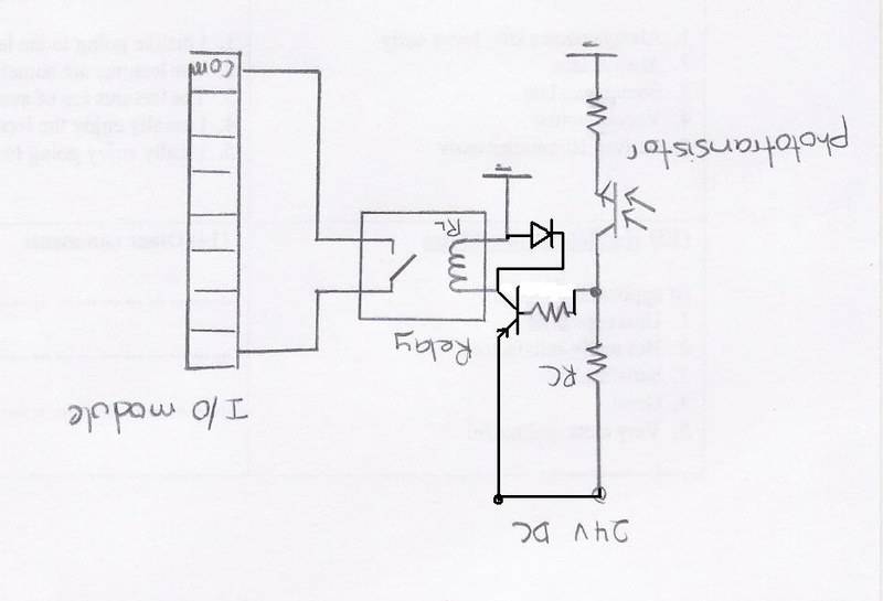

The phototransistor would not be able to drive that relay.
I think you need an amplifier between the two.
I have attached a simple modification that might be suitable.
It uses a PNP transistor with the phototransistor as its base resistor.
I also added a couple of safety resistors and a diode across the relay.
Thanks for correcting my circuit.
The addition of another transistor in the calculation is going to increase my headache up a few notch.
I would be appreciated if you can advice me on the phototransistor specification provided and how they are used in the calculation to select the appropriate resistor value.I am afraid I will get it all wrong in the calculation.

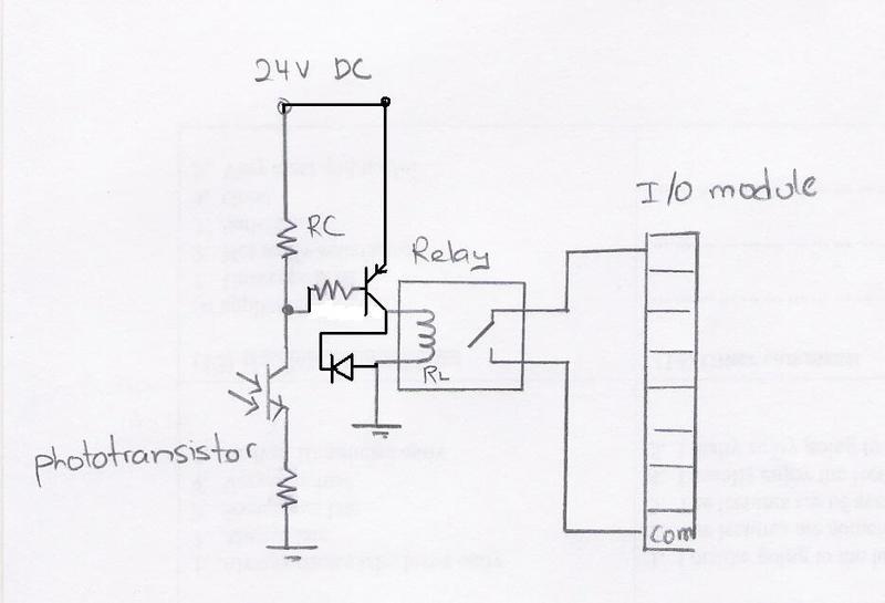

You don't mind adding a transistor, but it has to be NPN? Is that right?
Have a look at the attached diagram and ignore the diode being the wrong way around and the PNP transistor, does it look familiar now?
You would have to use a power PNP transistor. I would use a TIP32 which I know is available locally, but you might know something else.
Or, you could just use a NPN transistor in my upturned diagram.

No, it is just the same as a NPN except the polarity is opposite.
When the phototransistor is on, it acts as the normal base resistor of a transistor and turns the transistor ON. This causes collector current to flow through the relay and pull it in.
Select a PNP transistor that has a HFE of about 100. Work out the base current from this and then the current that must flow in the phototransistor.
If it still freaks you out, use an NPN power transistor.

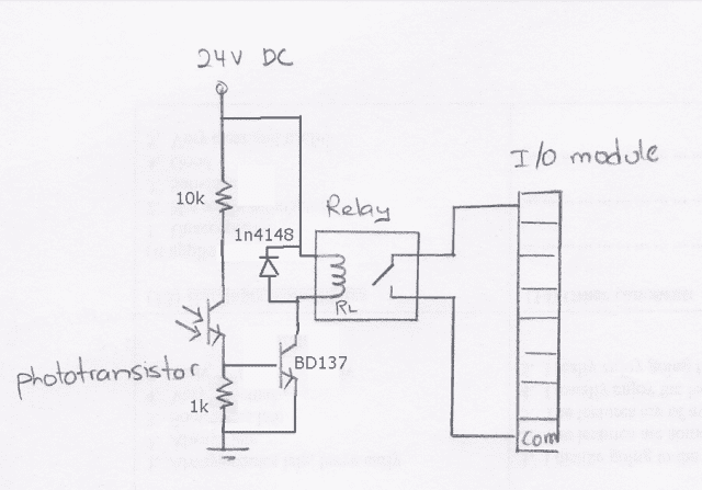

Stealth-Ray, if you really want to use only npn transistors then try the following. (the components shown are suggestions only.)
BTW. In the original circuit that you posted the relay was off when the photo-transistor was on and visa versa. Is that intended or required? Note that all the proposed modifications (including this one) work the other way around. That is, the relay turns on when the photo-transistor is on.

That's ok but at the with the present designs your relay will get close to 24 volts. Is that problem?
Then how about adding a resistor at collector of the pnp transistor?
Vcc = IcRc + Vce + V coil
Or can we try to reduce the vcc to 12 V? I guess the resistance of the circuit has to be very low so there is enough voltage to energize the relay.
Yes you can add a series resistor to drop some voltage but normally it would be preferable to choose a relay which matches your availalble voltage (or visa versa).
