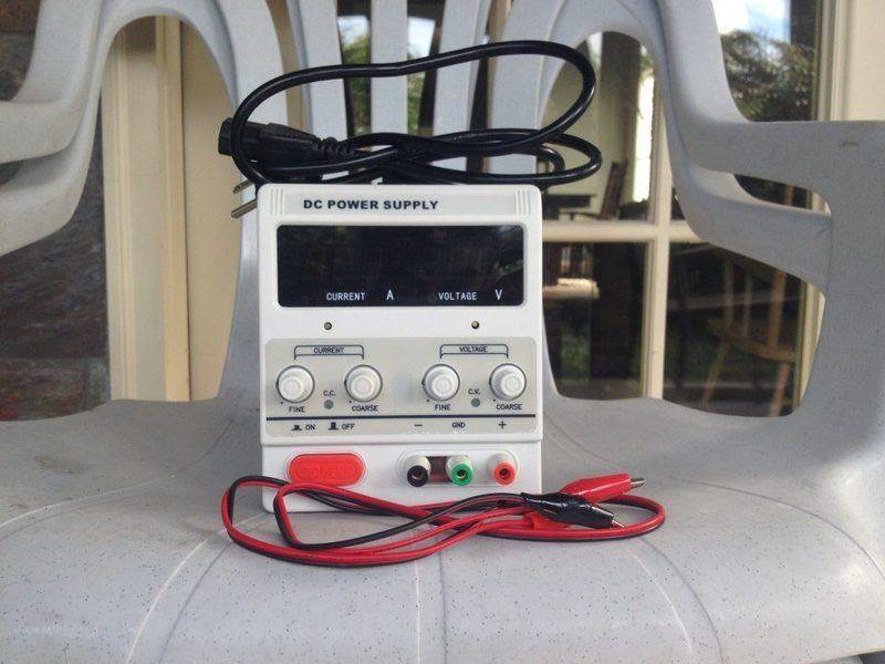

Allow me to explain. When I turn on the power supply (plugged into a wall socket) it has two display screens. One is for current (measured in amps), and one is for voltage (measured in volts, obviously). There are two knobs under each display screen labeled coarse and fine for changing the values of each. When I turn the coarse current value up to about the middle, nothing displays unless the positive and negative terminals are applied to a conductive material (I used a sodium chloride solution). When the current knobs are turned to the left all the way (0 amps?), when I change the values on the voltage by turning the coarse knob under the voltage display, the voltage number remains at zero. I expect it to change to a higher number but it does not do this unless I turn up the current knob past a tipping point and then it shows me the value of the voltage. This makes no sense to me either and that is why I hope you can explain this to me. Thanks!
I also have a picture of the power supply and all the cords that came with it:

What your power supply does is that it has a voltage limit, which you set with the voltage knob, and it has a current limit, which you set with the current knob. It increases the voltage until the first one of those limits is reached. So when you have the current knob set to zero, it will not increase the voltage because doing so would cause the current to increase above the limit which you have set (which is zero). As you increase the current limit knob, it is probably increasing the output voltage slightly, but it quickly reaches the current limit you have set. As you increase the current limit further, it reaches the point where the voltage limit is hit before it reaches the current limit, so you then see the output voltage increase. Does this make sense?

No, this is not correct. There can be a voltage even when there is no current flowing. It's just that the output will limit if it hits either the voltage or current limit. So if it hits the current limit, the voltage will be less than what the voltage limit is set for. As you increase the current limit above some point, then it hits the voltage limit first and the voltage limit then controls the output voltage.
If there is nothing connected to it (open circuit), you should be able to set the voltage regardless of the position of the current knob. But once you plug something into it, the current limit becomes active (if it is met).
Essentially, you need to decide, when you use it, what you want the limits to be. Depending on the experiments, you may not care about the current limit, so you can turn it all the way up and just let the voltage be set at what you want.

You didn't read what I wrote: I said "If there is nothing connected to it (open circuit)". If you have a piece of metal connected to the terminals, then you have a short circuit, not an open circuit.
Also why does it say there is no current when I set the current limit to maximum and the voltage to 0?
Because there is no current. Voltage is the force that pushes current. The voltage isn't a "limit", it is just the voltage. In a normal situation, the voltage just is what it is - whatever you set it to - and the current will be whatever the load demands. This power supply (pretty much all benchtop type power supplies) just has an additional feature that enables it to avoid the problem of too much current by providing a current limit, which pulls down the voltage if the current limit is reached.

The knobs under the current Meyer set the current limit. This is a safety feature to protect your circuit and the power supply in the event of a fault like a short circuit. When the set current is exceeded the power supply limits the current by turning down the voltage. So if your circuit is designed to draw say 1A set the current limit a bit higher than that, say 2A. If you set the current limit too low eg zero then it will immediately turn the voltage down or off. This is what you are seeing.

I am thinking that if the Current limit is set to Zero - then the PS is disabled, and will not output any voltage - regardless of the voltage setting. This may be used in a remote control mode, without having to add an enable - if a control calls for Zero current - the only way to ensure it is with zero voltage - consider the open circuit case situation and I limit at 0, V at 10V - then a load is applied - how does the PS ensure ZERO current - it can not since it will need to detect current to apply the current limit and it has then exceeded ( violated) the setting.
