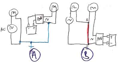

Hi folks, - please view the attached image -
my colleague and I had a major disagreement in the office.
We both mutually put a lid on the discussion as we both felt that we needed more information in order to make the other understand if we were right or needed more information to understand and accept that we were wrong.
I have attached the image for your perusal.

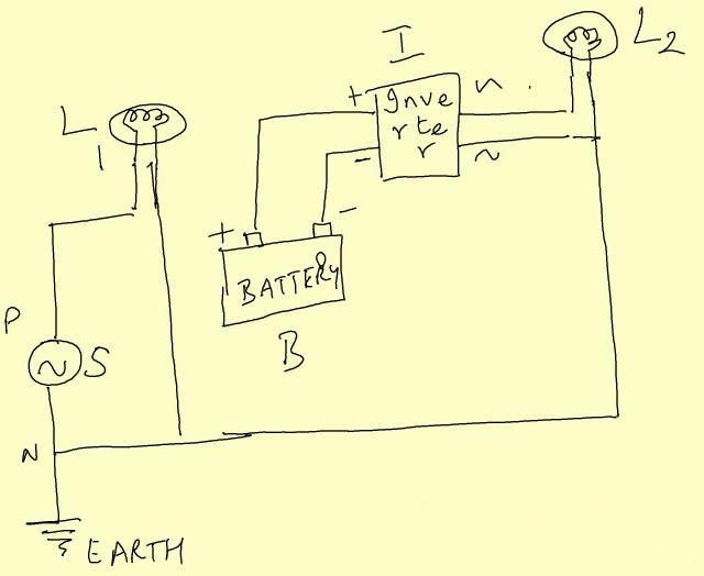

In the image we have discussed an arrangement where there are two primary inputs,
The voltage from a sinusoidal AC source, the voltage from a sinusoidal Inverter, sourced through a battery.
I'd like to name the AC mains voltage as Va and the inverter Voltage as Vi
The frequency of Va is 49 Hz, freq. of Vi is 50 Hz.
Hence there is a continual phasor difference between Va and Vi is continually varying.
Vi is held at ~230 VAC rms, while the voltage Va may vary from 0 - 250 VAC rms.
One phase of the AC mains is connected to the Earth point and so is one phase of the Inverter mains. Making them both the neutral phases of their respective voltage systems.
In no case are the live phases of the two systems brought into contact of the other.
In this setup, I believe that the Voltage Va and its phasor relationship do not affect the Voltage Vi and its phasor relationship or power factor.
I tried to explain to my colleague that the two systems are independent as only one line is shared and neither form a complete circuit with the other system.
Somehow this is not sufficient to make him understand my stance.
My colleague believes that the diffenece in voltage and phasor relationship would be detrimental to the loads L1 and L2, and also the malfunction or loading of one phase would trigger the loading of the other. i.e., if the voltage Va from the mains fluctuates, the fluctuations would affect Vi as the neutral is common.
I am not able to accept his viewpoint on that.

- if I am right I request you to kindly help me make my colleague understand the same.
- if I am wrong I request you to kindly help me understand were I am going wrong.
Please I know that this post may sound simple and childish to you,but the disagreement between us two colleagues is stalling a couple of our implementations in office.
