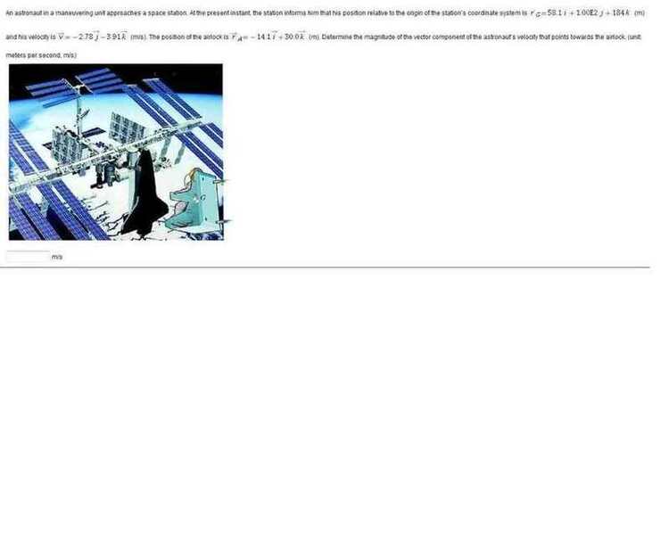

Hey guys, I am posting this question because I don't know what it is asking of me. Here it is:
Any tips or help would be nice. Thanks.
on Phys.org
You probably have to detemine the i vector component of the astronaut's speed to hit the airlock.
How do I go about doing that? The pictures confuses me.
Sorry I got it wrong, you have to determine the part of the velocity verctor that is parraler to the verctor pointing from astronaut to the airlock. Which is [tex]|\overline{v}| cos \varphi[/tex]. Using [tex]|\overline{v}||\overline{u}|cos \varphi = |\overline{v}\cdot\overline{u}|[/tex] you should get it.
OK thanks that makes sense. So would I Subtract Ra from Rg to get a vector and use the dot product with the velocity vector?
What am I doing wrong here. Here is the steps I was doing.
1. U = Rg - Ra = 72.2i + 100j + 154k
2. U . V (dot product) = -880
3. magnitude of V = 4.798. magnitude of U= 197.3
4. -880/ (197.4 x 4.798) = -0.9296 = 158.374 degrees (using cos)
5. magnitude of of V x Cos(158.374) = -4.46 <------ not correct
Please help!
