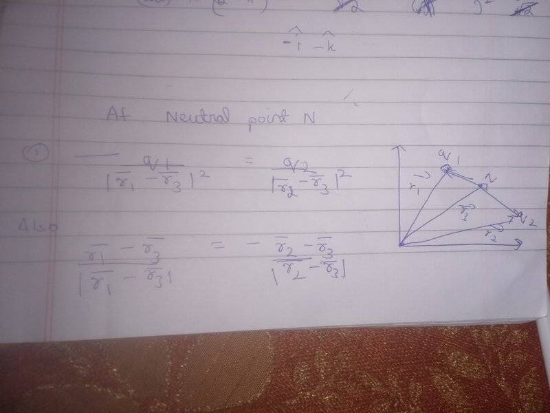

Position vector of q is î+j(hat)+2k(hat) and position vector of 4q is 2î+j(hat) +3k(hat). Find the position vector of neutral point.
Electric field vector due to q+Electric field vector due to 4q=0
This is the general suggested approach given in a textbook.
My question is why can I not directly write it in vector form?
E1 vector + E2 vector =0 should be valid no?
Why are they choosing to write E1 mag + E2 mag=0
Then find a vector form
Then convert the magnitude equation into a vector one?
What I did is:
I know we cannot cancel vectors so this just might be the worst approach but I dont get how we used the first approach just like that....

Another question in the book solution why is the ## \vec r_{13}## taken instead of ## \vec r_{31}##. Shouldn't the position vector to the neutral point be taken from the charge instead of the other way around in the electric field equation?
I need to see the book solution and how ##\vec r_{13}## is defined and used. Please post a photo of the relevant section(s).
Sorry its the first photo in post #1 Thats the book solution im talking about. And ##\vec r_{13}## is nothing but ##\vec r_1## - ## \vec r_3##
First, that does not look like a book to me but handwritten notes.
Second, I don't see ##\vec r_{13}## or ##\vec r_{13}## anywhere. What is it that you wish to know when you ask

Yes I cannot directly post the section from the book because its affiliated to a school who have sued others for pirating their books. I pirated it too so im trying to be safe:(
I understand that but in the immediate next line when they have equated the unit vectors they have used in the LHS :
$$ \frac { \vec r_1- \vec r_3} {|\vec r_1 - \vec r_3|} $$
And just beforce that in the LHS they are dealing with q1....so the unit vector of the position vector should be in the other direction I.e in the direction of the electric field lines from q1 to neutral point instead of neutral point to q1
Yes, that should be the unit vector from ##q_1## to the point of interest. It is the direction of the electric field from 1 to 3 if ##q_1## is positive and from 3 to 1 if ##q_1## is negative.
Exactly but the book does the opposite so its wrong?
Yup, and not worth pirating.

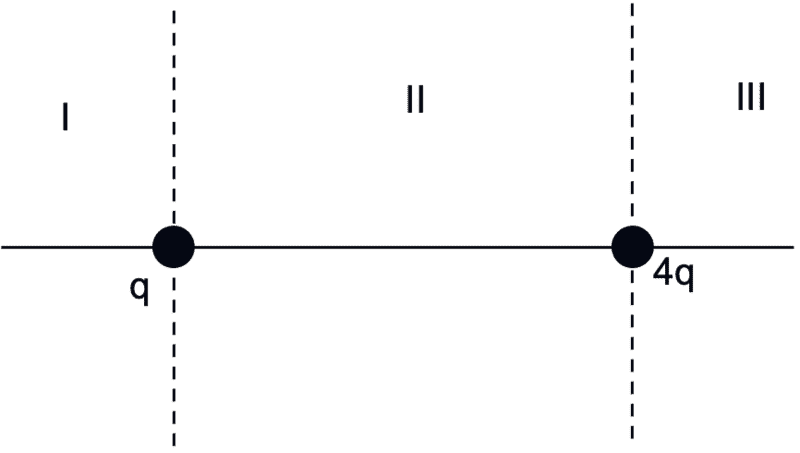

You are losing sight of your goal. You want two electric fields to get the zero vector $$\mathbf E_1+\mathbf E_2=0.$$ This means that one is the negative of the other,$$\mathbf E_1=-\mathbf E_2.$$ What is the angle between the two vectors when that is the case?
180
So at the neutral point, the two electric fields have an angle of 180° between them. Now look at the drawing below. It shows three regions in space, to the left of the charges (region I), between the charges (region II) and to the right of the charges (region III). Where do ou think the neutral point is and why? Add the neutral point and the two vectors at 180° to this drawing. I made it for this purpose and I don't mind if you pirate it. Then post your work.

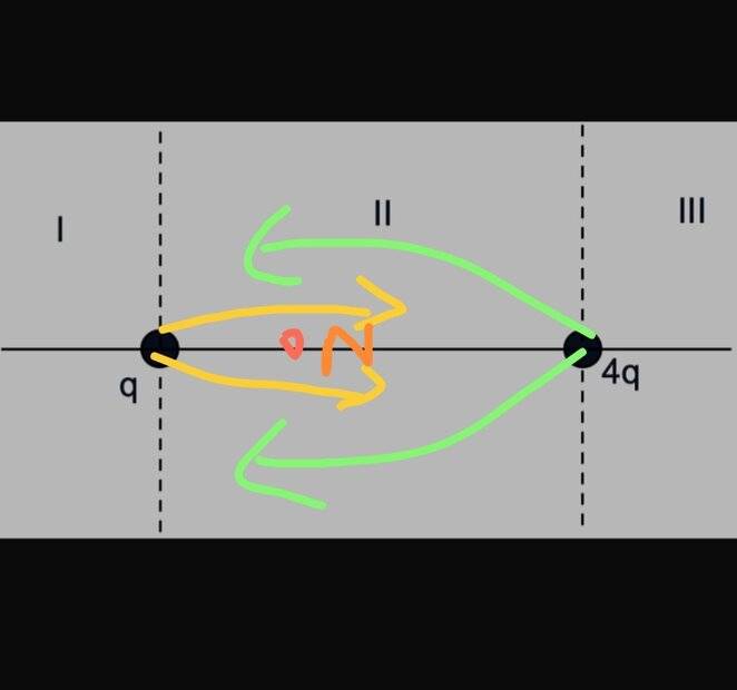

I believe it would be on the line joining the two charges because this is where the field lines are anti parallel. It is most likely closer to the smaller charge because of the inverse square law
I don't see any electric field lines at point N adding to give zero. Do you?
Pardon my drawing skills. In lower classes when we did neutral points it was a place with no field lines. Here its a bit different so I wasn't sure

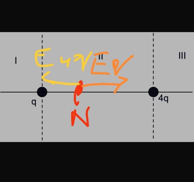

Not what I asked you to do. I asked to draw at point N the contributions to the electric field from each charge. In other words, at point N draw a field line representing the field from charge ##q## as if ##4q## were not there and then draw a second line at N representing the field from charge ##4q## as if ##q## were not there. Can you do that?
Very good. Note that this is another way of expressing zero at point N with vectors just like 3 + (-3) is another way of expressing zero with numbers. So when two vectors add to give zero, their magnitudes are the same and their directions are opposite. You put point N at some distance ##x## from charge ##q##. Can you find the value of ##x## if you know that the separation between charges is ##\sqrt{2}##?
Yes $$ \frac {kq} {x²}= \frac {k4q} {(√2-x)²} $$
