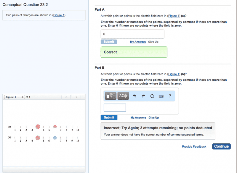

Mason Smith
Two pairs of charges are shown in Figure 1.
Two rows of charges on a number line marked 1 to 10: row (a) has a red positive charge at about 4 and a red positive charge at about 6; row (b) has a red positive charge at about 4 and a blue negative charge at about 7.
I originally thought that the electric field past point 7 (i.e. points 8,9, 10) was the solution. However, this is wrong. I then considered point 1, yet that was wrong too. I even considered that there was no point at which the electric field is zero. However, none of these guesses seem to be right. Where am I going wrong in my thinking?

Welcome to the PF. :smile:
What are the magnitudes and signs of the 4 charges shown?

MasteringPhysics labeled this question as a conceptual question, so no magnitude was given for the charges.
Actually, now that I zoom into the figure, I see the left-hand charges are +4 and the right charge in (a) is +1 and in (b) is -1.
So I would write Gauss' law for the charge configuration to see where the E-fields from the + and - charges got closest to zero (I agree it will be to the right of the right-hand-charge in (b)...
