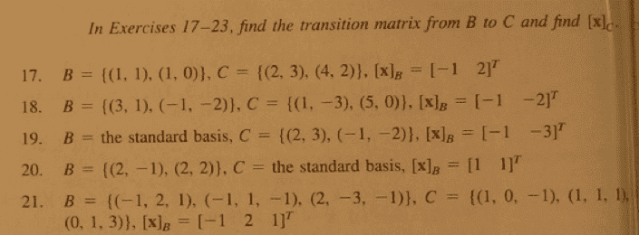

I'm enormously frustrated with these problems. I've been trying to figure out how to find out what the transition matrix between C and B is for about 2 hours and I still can't get it. I've watched 4 youtube videos and read two websites as well as the section in my textbook. I still can't get it. Anyway, this one video on youtube said that to get the transition matrix between these two matrices
[1 -1 0] [-1 1 0]
[0 0 1] [1 2 1]
[1 0 2] [0 -1 0]
you just put them together in a 3 by 6 matrix and reduce it to reduced row echelon form and the 3 by 3 matrix on the right is your transition matrix in this case
[-2 -5 -2]
[-1 -6 -2]
[1 2 1]
Well that method doesn't work for the problems I'm working on. Number 17 and 21. (I can get 19)
Using this calculator (if I calculated everything by hand I would have wasted 5 hours already)
http://www.math.odu.edu/~bogacki/cgi-bin/lat.cgi?c=roc
I get
[5 4 6]
[4 3 4]
[-2 -2 3]
the book says the answer is
[-7 -6 12]
[6 5 -10]
[-4 -4 7]
I can't get the right answer for 17 either but we'll just worry about 21 for now.
I'm still open to help for this problem, if anyone is capable.
Lets look at problem 21, for instance.
Observe that:
[itex]\left( <br /> \begin{array}{c} <br /> -1\\ <br /> 2\\<br /> 1<br /> \end{array} <br /> \right)<br /> = -7<br /> \left( <br /> \begin{array}{c} <br /> 1\\ <br /> 0\\<br /> -1<br /> \end{array} <br /> \right)<br /> + 6<br /> \left( <br /> \begin{array}{c} <br /> 1\\ <br /> 1\\<br /> 1<br /> \end{array} <br /> \right)<br /> - 4<br /> \left( <br /> \begin{array}{c} <br /> 0\\ <br /> 1\\<br /> 3<br /> \end{array} <br /> \right)[/itex]
So, the first column of my transition matrix will be [itex] \left( <br /> \begin{array}{c} <br /> -7\\ <br /> 6\\<br /> -4<br /> \end{array} <br /> \right)[/itex]
Decomposing the other two B basis vectors in terms of the C basis vectors in similar fashion will yield the two other columns.
