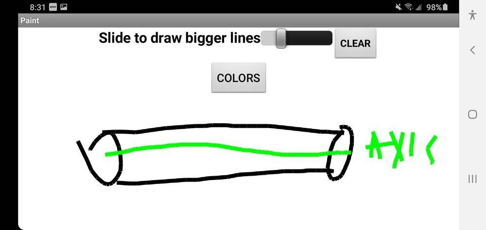

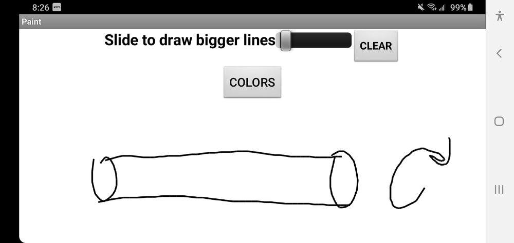

The dimensions are 6 inches long, and about an inch diameter. How do I lay it down, and spin it precisely, with absolutely no shake?
I understand that I need to know the exact radius, and find the center of each side. But, what do I do next?
1. Will the axis of the cylinder be horizontal or vertical?
2. Will it spin about the vertical or the horizontal axis?
3. How will it be mounted, what will it rest on?
4. How will you couple energy into it to start it spinning?

Thanks for the scientific response. Aren't question 1 and 2 the same? I think I should say that I need it to spin on the vertical axis, if it was standing up. The horizontal axis, if it was laying down. But, I usually say: "Iimagine a pencil laying down, and spinning it on its own graphite." Is that the vertical or horizontal axis?
Questions 1 and 2 are different, but connected.
Do you know what the principle axis of a cylinder is ?
Do you know the difference between a vertical axis and a horizontal axis ?
Then you can answer the first two questions one at the time.
StevenRice said:
"But, I usually say: Iimagine a pencil laying down, and spinning it on its own graphite."
Do you mean it's point where the graphite is exposed?
Or do you mean spinning about the principle axis that follows the centre of the graphite along the pencil ?
Things spin about an axis. Things spin on a support.
How would it be supported ?
You need to describe it clearly by answering the questions, or attach a sketch.
I am not a great artist, but I drew this on my Android phone. The spin I'm talking about actually has almost NO movement. I asked my brother about it, and he said that I should put it on something like a rotisserie.

That may be an absurdly stitch requirement. But if what a ball bearing can provide is acceptable then you may put in or around your cylinder a bearing. For any general usage it should do.
I believe that a bearing may be a good solution. But, how do I attach the bearing to the cylinder?
Bearings come in many types and sizes. https://en.wikipedia.org/wiki/Ball_bearing
Push the cylinder into the bearings. House the bearings in holes bored in parallel walls.
The type of bearing will be important. What is the cylinder diameter?
The cylinder will sag due to gravity, so you may need two or more bearings, at maybe 25% and 75% of the length depending on requirements.
How fast will it spin? At some speed the cylinder will become bowed and will twirl. It will need to be controlled by positioning bearings.
