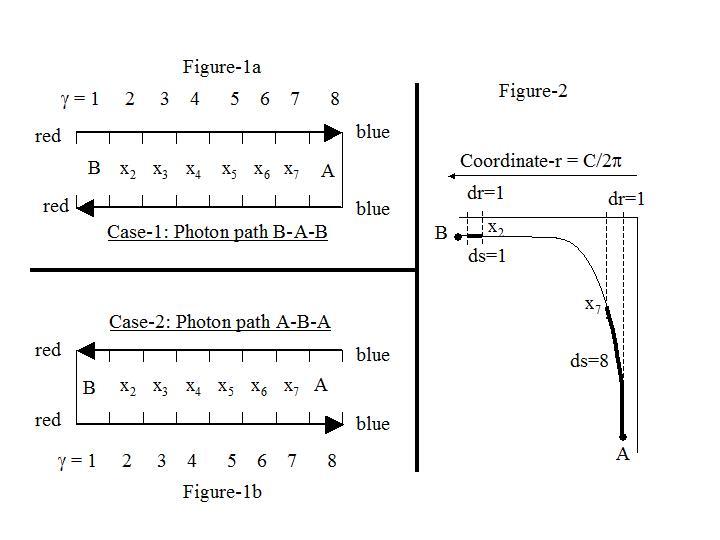

Jorrie and I were of the opinion that the radius calculated by a local observer by measuring circumference would agree with radius measured by the observer at infinity.
Yes, I agree. By definition, the calculated radius or coordinate-r corresponds to that measured in flat spacetime. Wasn’t too sure about the next bit, as I would have thought we could simply say that the circumference was measured without reference to any velocity. However, I agree that horizontal/tangential circumference would not be affected by gravity. At this point, I would like to introduce two definitions, although you will probably disagree with the second:
[tex]Coordinate-r = circumference/2\pi[/tex]
[tex]Spatial-r = \gamma(coordinate-r)[/tex]
The implication of the second definition suggests that the radial distance expands, although it is probably not measurable by the local observer for the following reasons starting with your words:
Yes, the local observer can never measure the change in the proper length of his ruler. I prefer to think that the observer at infinity sees the ruler as length contracted when orientated vertically.
While you begin with `Yes`, I don’t think you will agree with my statements at the end of section-3. I was assuming space expands in the radial direction due to the increasing curvature of space. However, I was also assuming that the local ruler would also be affected and therefore the increase in the spatial-radius is not measurable locally, only observed at a distance. So, to conclude, let me try to apply my assumptions to the 2 observers under consideration, i.e. the distant observer (x, t) and the shell observer (x`, t`) within the gravity well using my assumptions:
x` > x, i.e. [tex]x’ = \gamma(x)[/tex]
t` < t, i.e. [tex]t'= (t)/ \gamma[/tex]
The velocity [v] is a function of distance over time:
v' = x'/t' [tex]= \gamma(x)/ (t)/ \gamma = \gamma^2 (x/t)[/tex]
As such, [v’] is greater than [v] by [tex]\gamma^2[/tex] as required by the very first equation. Again, apologises for such a long posting, but as stated, I wanted to try and address all the open issue from my current understanding.

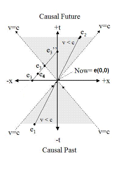

Response to #37/#38
This posting is trying to get clarification or verification of a number of concepts raised throughout this thread, in particular postings #37/#38.
o SpaceTime Interval
o Proper Time
o Proper Length
The attachment st1.jpg is used as an initial reference to a Minkowski or spacetime diagram. Based on this geometry, the proper time is defined as:
[1] [tex](Proper Time)^2 = (t^2 - x^2/c^2)[/tex]
Within the causal past and future, [t] is normally greater than [x], while the interpretation of proper time is given below. Of course, in the case of (e3), [x] can be greater than [t], which would require the square root of a minus number. Therefore, in this case, it seems that the alternative definition of the spacetime interval is often preferred:
[2] [tex](Space Interval)^2= (x^2-(ct)^2)[/tex]
In essence, both these quantities seem to represent the spacetime separation in units of time or distance. The following definitions of `proper time [To]` and `proper length [Lo]` may not be rigorous, but hopefully anchors some meaning to a specific example. These definitions align to the statements made in #37/48, i.e. T = To*y and L = Lo/y, but it is believed that some caution needs to be exercised in how these statement correspond to time dilation and length contraction as implied by the Lorentz transform.
Definition of Proper Time [To]
Proper time [To] might initially be defined as the `wristwatch` time of an observer moving between 2 events with velocity [v]. This time would differ from the time [T] of a stationary person watching the observer move between the 2 events such that:
[3] [tex]T = To*\gamma[/tex]
See attachment st2.jpg for the equivalent spacetime diagram. The diagrams alludes to 2 events (A) and (B). A stationary observer measures the time (5) and distance (3) taken by a moving observer to reach (B) from which the proper time corresponding to the wristwatch time of the moving observer is calculated to be 4. This suggests that time for the moving observer is running slower than the stationary observer. On the basis that the velocity [v] is invariant between both the stationary and moving observers, we might also determine the distance/length between (A) and (B) as determined by both observers, i.e.
Stationary Observer: x=vt=0.6*5=3
Moving Observer: x’=0.6*4=2.4.
The implication being that the length with respect to a moving observer is contracted. However, we will see how this statement might be misleading in some examples.

Hi mysearch,
I have attached a slightly modified version of your first diagram to the aid the discussion. (hope you don't mind).
From the attached diagram:
e1 and e(0,0) are causally connected and said to be "time like separated". Ther is no reference frame in which they can be considered to be simultaneous. Same goes for events e(0,0) and e2 and e(0,0) and e3''.
e3 and e(0,0) are "space like separated" events as they can not be casually connected. e3 and e(0,0) are example of where delta(x) > delta(t)*c and in this case delta(t) =0. It is also true that delta(x)/c < delta(t) in this case. A reference frame in which two space like separated events are considered to be simultaneous can always be found. e4 and e(0,0) are also space like separated.
e(0,0) and e3' are "light like separated" and the two events can always be connected by a light signal according to any observer.
Ref: http://en.wikipedia.org/wiki/Spacetime

A couple of thoughts to add to your deliberations.
Let A be an observer on the surface of a very dense gravitational body and B is an observer far out in space. They agree on their radiuses rA and rB as defined in by assuming R=circumference/2pi.
B sends a light signal down to A which is reflected from a mirror on the surface and returns to B. He notes that the round trip time for the light signal is greater than the 2(rB-rA)/c. Now B can draw two equally viable conclusions:
(1) The speed of light is constant everywhere and the "real" distance rB-rA is greater than that calculated by assuming the relationship R=Circumference/2pi.
(2) The speed of light slows down as it falls and takes longer to travel the fixed distance 2(rB-rA).
Now A sends a light signal up to B where it reflected by a mirror and returns down to A. He notes that the round trip time for the light signal is less than the 2(rB-rA)/c. Observer A also comes to two equally viable alternative conclusions:
(3) The speed of light is constant everywhere and the "real" distance rB-rA is less than that calculated by assuming the relationship R=Circumference/2pi.
(4) The speed of light speeds up as it climbs out of a gravity well and takes less time to travel the fixed distance 2(rB-rA).
Note that conclusions (1) and (3) contradict each other, while conclusions (3) and (4) are compatible.
Observers A and B conduct some more experiments measuring the redshift of signals and measuring the radial distance directly with rulers and pool all their information to reach the following conclusions:
(5) The coordinate speed of light progressively slows down by Gamma^2 as it falls and speeds up by Gamma^2 as it climbs.
(6) Clocks progressively slow down by a factor of Gamma, deeper in a gravitational well.
(7) Rulers progressively length contract more by Gamma the deeper you go in a gravitational well.
(8) The combined effect of conclusions (6) and (7) is that the local speed of light is always measured to be c.
(9) The Euclidean radius obtained from circumference/2pi is a true radius but the length contraction of rulers can make it appear that the radial distance does not satisfy the Euclidean relationship. The timed two way vertical speed of light is not consistent with the radial distance being greater than circumference/2pi.
A.T. posted this nice visulisation of the relationship of velocity, acceleration and curvature to length contraction here: http://www.adamtoons.de/physics/relativity.swf that might be worth having a look at.
Response to #51
Kev,
Thank for both replies, both were very helpful and I will respond to both via separate posts starting with #51. I think we have broad agreement with the generalised spacetime diagram, i.e.
o e1 & e2 are both time-like and causally connected to e(0,0).
o e3 is space-like and not causally connected with e(0,0)
o e3, e3’ and e3’’ is a path moving through spacetime with respect to e(0,0)
o e3’ can become causally connected with an event (light beam) emitted from e(0,0) at some point in the future
o e3’’ can collide with e(0, t) at some time in the future.
o E4 is another space-like event, which if stationary with respect to e(0,0) will remain space-like and simply maintain the same position through time.
There is always an ambiguity of which observer is moving relative to the other in relativity
I know why you have highlighted this, but I would like to raise another example and ask your opinion. However, I will do this in a separate posting outlining a `triplet paradox`:rolleyes:
Equally, as you have provided a good example of the caveats raised in your subdequent post ( #52), it makes sense to respond to all your comments in my response to #52. However, as you have highlighted, some of the caveats raised have relevance to the Bell paradox, which I am still trying to understand. In many ways, these questions are simply trying to confirm/reject some initial assumptions before addressing this paradox head on.
Response to #52
Kev,
Thanks for the example; I find it really helpful to have something tangible to reference. All to often, standard ‘explanations` simply regurgitate pages of mathematical derivations and buzzwords, when a simply example would be far more helpful. The link to the simulation was also very useful, but I am not sure whether I am totally in synch with its results – see footnote as this is not the focus of my response.
Your basic example:
Let A be an observer on the surface of a very dense gravitational body and B is an observer far out in space. They agree on their radiuses rA and rB as defined in by assuming R=circumference/2pi.B sends a light signal down to A which is reflected from a mirror on the surface and returns to B. He notes that the round trip time for the light signal is greater than the 2(rB-rA)/c. Now B can draw two equally viable conclusions:
Now the first conclusion/assumption seems reasonable enough starting point, but I would consider the issues a little further.
When we discussed `gravitational redshift`, we are actually referring to the effects on a photon’s frequency as it moves out of the gravity well. If the photon is falling into a gravity well, the photon is said to undergo blueshift. This suggests that the effects on the photon are asymmetric in terms of its direction in the gravitational field. In terms of the Newtonian view, the photon would lose energy to the gravity field when moving away from mass [M], but gain energy when falling towards it. On this basis, would you not expect the effects of the velocity of light to be asymmetric?
Now normally, the assumption is that the velocity has to remain constant, because the media defines the velocity of a wave and energy defines the frequency (E=hf). However, if the gravitational field affects the permittivity and permeability of vacuum, then it might be possible for the velocity of light to change. However, if this were the case, would this not have knock-on implications on the frequency [f] as [tex][c=f\lambda][/tex]?
Again, there is the asymmetric/symmetric issue. It is my understanding that gravity causes a curvature of space. This curvature means that the geodesic path is ever-greater than coordinate-radius defined by [tex]r=c/2\pi[/tex]. Based on simple geometry, one might assume that A-B = B-A, which implies the round trip distance is the same. However, there is the complication of the direction of gravity that transposes to acceleration towards and away from the mass [M]. Therefore, I am not sure whether A-B = B-A?
At one level this makes sense, as the curvature flattens when moving away from [M], therefore [c] appears to cover more coordinate-r in unit time. However, I not quite sure how to reconcile this view with the energy associated with the photon, i.e. photons lose (kinetic) energy to the gravitational (potential) field?
Certainly, the solution of the Schwarzschild metric for the distant observer supports this statement, although it is predicated on the assumption that local time for the photon has stopped and distance has contracted to zero. The premise of this standard assumption might be considered comparable to some of the physical ambiguities said to occur at the event horizon. However, statement (6) is the logical extrapolation of the previous assumption and apparently supported by experiments related to time dilation. I raise these points not to be argumentative, but simply to highlight where the `limits of inference`, separating fact from hypothesis, may exist.
Again, I am raising points for clarification, rather than forwarding my own speculative hypothesis. When length contraction is discussed in the context of velocity, the observer perceives all objects on board a moving spaceship to contract in the direction of motion, including local rulers. In a sense, the motion distorts the perception of everything including atoms. As such, the moving observer perceives no change and the speed of light remains invariant, i.e. c= x/t = x’/t’.
The implication of (7) is that ruler onboard a spaceship moving into a stronger gravity well also contracts, which then maintains the constancy of [c] by the same logic as above. However, the path that the spaceship is moving along is expanding in the radial direction in comparison to the coordinate-radius. We seem to have 2 different mechanisms, the first affects physical objects within the moving space, while the second only expands the perception of space, but not the objects within it?
It is probably best fore me to timeout at this point.
Coordinate geometry using [tex]r=c/2\pi[/tex] says A-B=B-A.
Local measurement using rulers says A-B=B-A but the distance is greater than [tex]r=c/2\pi[/tex]
Measurements sending light signals say the distance ABA is greater than BAB where A is higher if the speed of light is assumed to be constant.
Measurements sending light signals say the distance ABA=BAB if the speed of light varies according to c'=c/Gamma^2 and that by making this assumption then ABA=BAB=2(A-B)=-2(B-A)=(A-B)-(B-A).
So only the conclusion reached by assuming the speed of light is constant everywhere in a gravitational field gives an asymmetric result that ABA>BAB.
