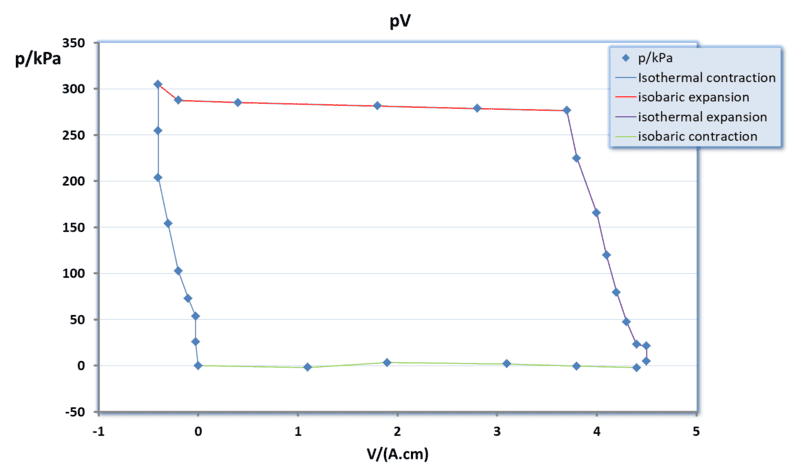

Samir_Khalilullah
Imagine a piston full of gas. First we place it in cold water so that it contracts isothermally (constant temperature). Then we remove it from the cold water to allow it to expand isobarically (constant pressure). Then we move the piston to a hot water bath so that it further expands isothermally. And lastly we remove it from heat source and it contracts isobarically. We continuously collect data of pressure of the gas and the position of the piston. Piston diameter was 3.25 cm and mass of 35g. The cold and hot water had temperatures of 8.7°C and 58.3°C respectively. There were 0.05 mole gas inside the piston. Please note: Here initial position and pressure are marked zero, these are not actual zero.
(see data in the attachments)
A) Plot the PV diagram of the situation
## P V = n R T ##
I don't really know how to start here

Begin by identifying which set of data is which process.
What is the weight of the piston in N?
What is the area of the cylinder in m^2?
What is the pressure contributed by the piston in Pa? in kPa?
Do they really mean that you have a piston full of gas, or that you have a cylinder full of gas covered by a piston?
In the third set of numbers, there are negative pressures. How can that be?

Dear @Samir_Khalilullah,
All we can see is that the exercise asks you to plot ##p## versus ##V##. That's pretty clear, isn't it ?
What stops you from posting your result ?
I suppose there is more to come, but telepathy isn't very developed in the PF community. Guessing is usually missing.
So please show us your plot and parts B) and onwards ...

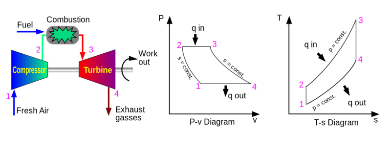

I find the wording rather weird: Isothermal contraction, isothermal expansion where I expect a ##\Delta T\ne 0## ?
And a pV diagram similar to that of a Brayton cycle
The left set of points is at constant temperature 8.7C, the top set of points is at constant pressure, the rights set of points is at 58.3 C, and the bottom set off points is at constant pressure.

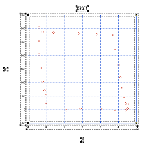

Well, we've done part A) of the exercise -- except that we haven't calibrated the axes .
I have pV = nRT = 117 J on the left and 138 J on the right.
With ##\Delta V / A\approx 4.5## cm so ##\Delta V\approx 3.7 \times 10^{-5}## m3 that would set p to some 5.5 Bara. Don't know how to connect that to the p axis...
Graph titled pV with p/kPa on the vertical axis from -50 to 350 and V/(A.cm) on the horizontal axis from -1 to 5, showing a closed cycle of four curves labelled isothermal contraction, isobaric expansion, isothermal expansion and isobaric contraction.
Let x be the piston location in cm relative to the offset origin 0,0 in the figure and let y be the value of the pressure at 0,0. Using the ideal gas law at constant pressure, we have $$\frac{4.5+x}{x}=\frac{273.2+58.3}{273.2+8.7}$$This gives x=25.6 cm, and an actual volume at y=0, T=8.7 C of ##\pi (1.625)^2(25.6)=212.4\ cc =0. 2124\ liters##. The volume at the lowest pressure y =0 and T=58.3 C is then 0.244 liters.

I followed the same procedure as you and got the same number for the volume offset.

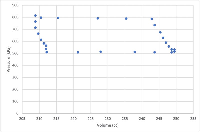

I then added the correction factor to the volumes and proceeded to find the pressure offset. To do that
  • I took the intersection points of the low pressure isobar with the two isotherms. These were raw data points (0,0) and (4.5, 21.5).
  • I calculated the pressure at these two points from ##p=\frac{nRT}{V}## with the ##V## the corrected volume, ##T## the high and low isotherm temperatures converted to Kelvin and ##n=0.05.##
  • I got ##p_1=510~##kPa. I added this offsets to all the pressures to get the corrected pV plot shown below (no suppressed zeroes).
I note that, unless I made a mistake somewhere, the pressures are quite high relative to atmospheric and the 35 gram piston will be shot out faster than a speeding bullet. Now what?

Did I make a mistake on the high volume end? I gat 244 cc compared to your 249 cc?
I don't think they meant for the piston to be providing all the pressure. I think they meant for external pressure to be applied on the piston, and for the external pressure to be increasing during the isothermal expansion at the left, and decreasing during the isothermal compression on the right. Also, the pressure applied bu the weight of the piston is a tiny 0.4 kPa (insignificant).
There is a problem with using 0.05 as the number of moles. Along the isothermal segments on the left and right, the product of PV will not be constant. Or, put another way, if you consider PV constant, and calculate the V values along the left and right sequences, the predicted volumes will significantly deviate downward from the observed values. Try again with 05 moles and see what you get.

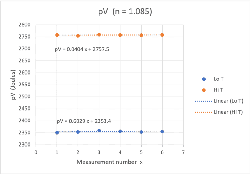

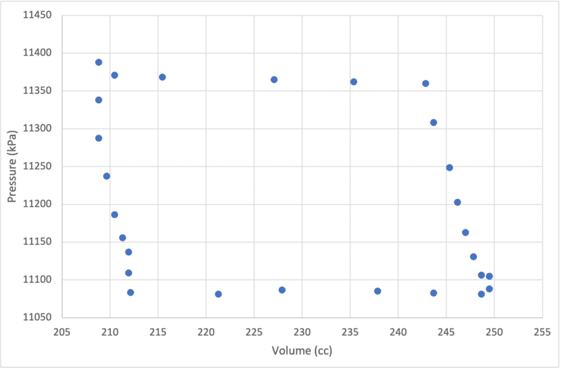

I plotted pV vs. measurement number for 6 data points for the high and low temperature isotherms. I put a linear regression for each and varied ##n## by eye until I got slopes close to zero. That gave me a value ##n=1.085.## The plot is shown below. The second plot is the entire cycle for this new value of ##n## and is the old plot with the pressure axis rescaled.
I don't think there is more to be done with this.
Scatter plot titled pV (n = 1.085) of pV in Joules against measurement number x from 1 to 6, with two series of points each with a dotted linear trendline: Lo T near 2350 J labelled pV = 0.6029 x + 2353.4, and Hi T near 2757 J labelled pV = 0.0404 x + 2757.5.
Scatter plot of Pressure (kPa) against Volume (cc), with pressure from 11050 to 11450 and volume from 205 to 255, showing a closed loop-like cycle of blue points.
At 8.7 C, a PV value of 2350 J corresponds to a number of moles of ##\frac{PV}{RT}=0.97\ moles##.
AT 58.3 C, a PV value of 2750 J correspond to a number of moles of ##\frac{PV}{RT}= 1.00\ moles##.
So your results confirm that the number of moles should be >>0.05 moles, and, instead is about equal to 1.0 mole.
