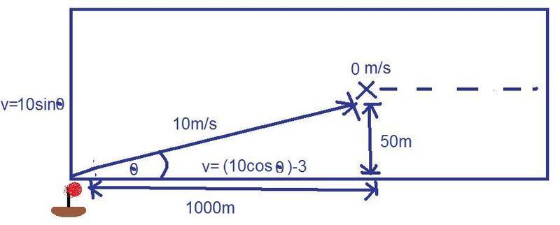

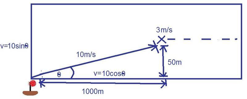

Post a diagram and then explain your attempt.
the scenario is the first diagram.

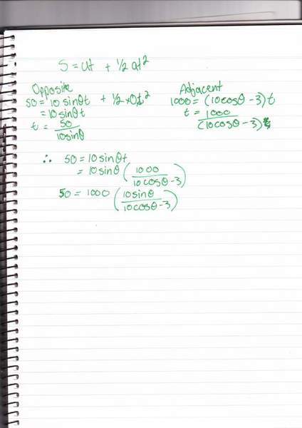

what i was thinking was diagram two. make the swimmer 0m/s. The only acting force for him is along the adjacent side, so the adjacent velocity will have to be 10cos[tex]\Theta[/tex] minus the 3m/s of the swimmer.
s = ut + 1/2at^2
Adjacent side Opposite side
50 = 10sin[tex]\Theta[/tex]*t + 1/2*0*t^2 1000=(10cos[tex]\Theta[/tex] - 3)*t
50 = 10sin[tex]\Theta[/tex]*t + 0 t= 1000/(10cos[tex]\Theta[/tex] - 3)
T=50/(10sin0[tex]\Theta[/tex])
Therefore: 50 = 10sin[tex]\Theta[/tex]*(1000/(10cos[tex]\Theta[/tex] - 3))
50 = 1000*(10sin[tex]\Theta[/tex] / (10cos[tex]\Theta[/tex] - 3)
If this is anywhere near the right track I am lost here.
