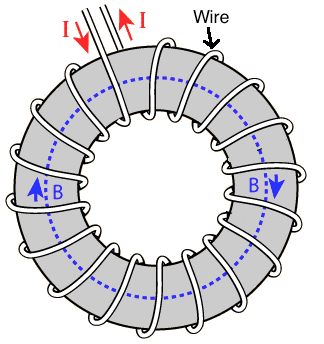

So you want a permanent magnet like this:
Diagram of a toroidal coil: a grey ring-shaped core wrapped with white wire windings, with two wire leads at top labeled I and dashed blue circular lines marked B showing the magnetic field direction around the core.
only without the wire?
I don't think anyone makes such a thing. As NascentOxygen says:

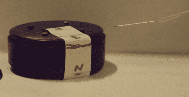

But the magnetic flux field is not as requested.
Part Toon said:
I require a special kind of magnet to complete my project, a magnet that the flux field lines continuously go around clockwise or counter-clockwise. Very similar to the magnets that were used in the REALLY old computers to store memory
Unless of course, you have really weird speakers down under.
Here is a picture of one of my old speaker magnets, with the poles annotated.
Photo of a black cylindrical speaker magnet with a white label band marked N, with a sewing needle suspended in air beside its top edge.
The sewing needle is suspended in air, and is pointing to the strongest part of the south pole.
The north pole is strongest in the center of the top.
The poles may have shifted, from what was originally designed, as the space around the central magnet is now filled with iron filings.
(I used this magnet to look for my keys one day, 10 years ago, underneath 20 feet of water. I found my chair. [ref] I eventually found my keys, 3 months later.:partytime: One of these days, I'll finish that story. :redface: )

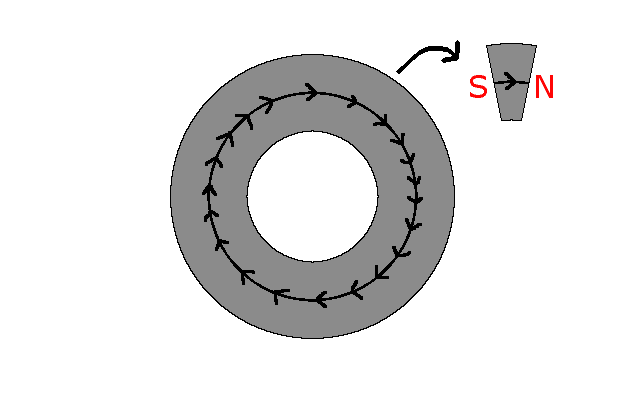

It appears that there are a lot of ideas for what I need, I decided to make a .png image to demonstrate...
https://physicsforums-bernhardtmediall.netdna-ssl.com/data/attachments/84/84646-5270c0cfad4a3b7d3ad8d72f7e935d59.jpg
(it may look a little cheap, I assembled it in a couple of minutes :P)
EDIT: I just realized how small the image is :P You may need to download the image by dragging it to your desktop to see the details :P
This is the kind of magnet that I need, it must be a permanent magnet, that is all a single piece. I simply cannot use multiple magnets that were attached together :P
So... would any of you know what this sort of thing is called? And how I could either make or purchase one? Maybe a specific Ebay post, or a store that carries a wide variety of magnets? Or I might be able to create one if I knew how...
P.S. The magnet must also be a few inches in diameter.

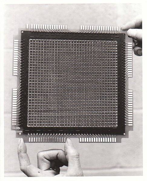

Part Toon said:
I have a question, the magnets used in old computers (core memory as I heard it is called), aren't they simply miniature versions of what I need?
they were not magnets, they were ferrite cores that would be magnetised with the data signal passing through them on a wire
and in general they were tiny ... I used to have a chunk of core memory, the cores were a couple of mm in diameter
Photo of a square core memory plane held by two hands, showing a dense grid of tiny ferrite cores threaded with wires and pin-like connectors around the edge.
Diagram of a magnetic core with X drive, Y drive, inhibit, sense, output, read and write lines passing through it, labelled Figure 6-3, showing flux directions for 1 and 0.
https://en.wikipedia.org/wiki/Magnetic-core_memoryDave

I do know that ferrite is a material that has the ability to become a permanent magnet, most of my magnets are made of ferrite. So do you think I might possibly be able to magnetize a piece of non-magnet ferrite (or any piece of material that can become a permanent magnet) into the way that I require, by doing the same thing that the core memory thinga-ma-doodles did?
If you want a strong field I would recommend a neodymium magnet.
You can just get yourself a ring shaped magnet and remove it's magnetization by heating it above it's curie temperature e.g. with a blowtorch.
Then you magnetize it again with a coil of insulated wire wrapped around it.
In this video - starting at 10:00 min - you can see how this is done in a factory with coils of wire and a capacitor to achieve very high currents.
But I wonder why you won't tell us what you need this for. It doesn't have anything to do with violating the laws of physics, does it?

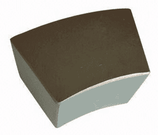

What about using a series of wedge shaped magnets :
Photo of a single curved wedge-shaped permanent magnet, with a dark brown top face and a light grey side face, with a curved outer edge.
Their North-South poles can be oriented on the sides so that the fields rotate as required, and the equivalent of a flat iron washer can be placed on either side to link the fields. What you then have (and must end up with based on your diagram) is an alternating North-South set of poles (much like in a linear accelerator) around the circumference.

I like your idea :D I think I should try that. It'll take some research on the correct material to use, and what it's curie temperature is, but after that, I think I give it a shot.
But what Allan just said about the wedges, I have tried something similar to that. I used 24 magnets all put together to make a ring, however, there were imperfections within it, for it was not all a single piece. There were exposed North and South poles :P It simply could not work for me in my case.
