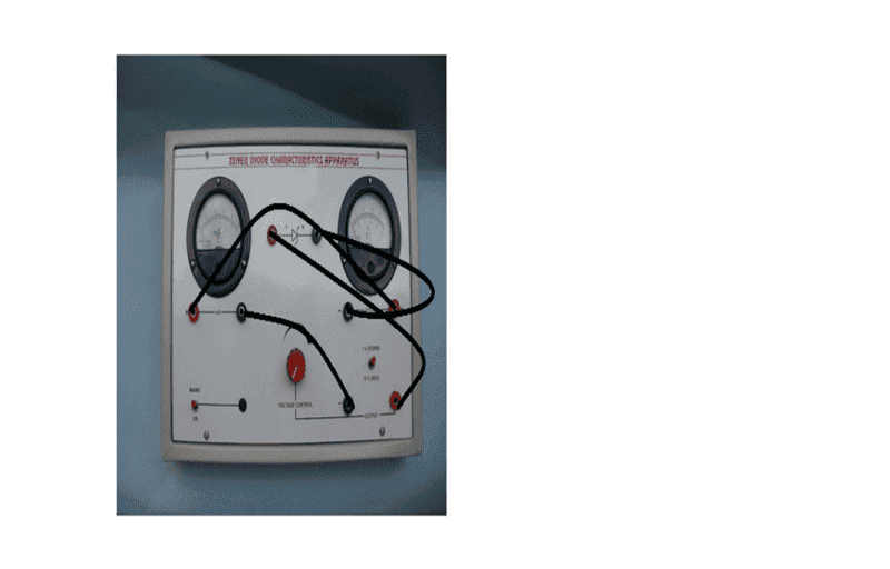

I don't know how to do connections.I just know how to do it in specific type of zener diode because i have learn this.I don't understand these connections.Within 30 minutes i have to leave for my exams please help.
[/B]
-[/B]
I really don't have any idea.I think it should be like this
Please give me general idea how to do connections so that i can do in any kind of zener diode.Please it's urgent.

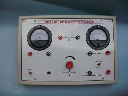

Well, I'd love to help, but the pics of the instrument don't help much.
Basically you will want to plot the I versus V characteristic, for both positive and negative bias of the diode. Use Google Images to see what that IV curve looks like to help you with your lab prep.

You have the wrong polarity connection for measuring the zener effect. You also seem to have the wrong connection for the voltmeter. The voltmeter should be connected parallel to the diode, but you show both meters in series with the diode. There needs to be a double-adapter available so that you can plug two wires into the one socket to get this right.
Can you further elaborate this?
The easiest way to get this right would be to connect up the voltage source, the zener diode, and the ammeter. Then, without changing or unplugging any of these wires, add 2 new wires to connect the voltmeter directly across the diode.
Gingerly adjust the voltage source until the zener current is a few mA. (I say gingerly because there seems no resistance is present to limit the current, so beware that current may increase suddenly with ony a tiny change in voltage source level.)

But it is really helpful to me.Can you please correct my connections in the diagram? .

How?In series?
Yes, these all in series, except not the voltmeter. A voltmeter always connects in parallel to the voltage it is to measure.

Yes, that's close enough. Though on your apparatus it is called "voltage control".
The designer has introduced some ambiguity (presumably with the best of intentions) by including a switch labelled forward & reverse, but failing to indicate whether the switch function applies to the voltage control, or maybe the voltmeter. Groan. :(
You can't be sure until you try it.
Does the lab include any sort of instructions with the "box?"
Bystander said:
"box?"
Which box?
The box with the meters, and power supply.
It might be a virtual apparatus.
NascentOxygen said:
virtual apparatus.
That switch --- range for voltmeter? Range for PS output? Commutator for zener socket?
