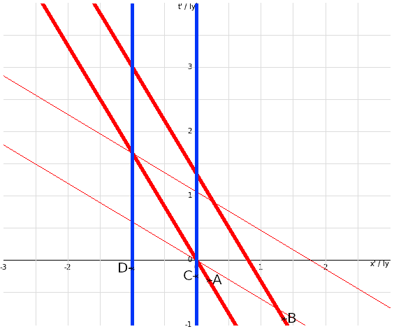

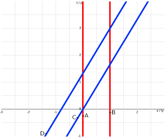

Ibix said:
Here are a few spacetime diagrams. If you haven't come across them, they're simply plots of the position of an object over time, the custom being that time goes up the page. So a vertical line represents an object that isn't moving, and a line slanted to the left indicates one moving to the left. You may have come across these (usually with time horizontally) as "displacement-time graphs" in high school physics. We take them a little more seriously in relativity, since spacetime is a thing - these are maps of spacetime, and the lines are the 4d objects inhabiting it. You see one 3d slice at a time.
So here's your scenario, with my extra "D" observer. A and B are marked in red and are stationary, C and D are marked in blue and moving to the right.
Note that, in this frame, C and D are closer together than A and B - the horizontal distance between the lines ("the space between them") is shorter.
We could mark on the diagram the start and end of the experiment - when C passes A and then B. Let's do that with fine red lines:

Here's the original diagram, followed by its boosted version.
If you look at these a little bit and learn how to interpret the geometry and physics encoded,
I think that you can see that they convey the same information...
(...Like a rotated photo has the same information as the original photo.)
by counting ticks and sticks.... and by interpreting the diagonals
of an inertial observer's light-clock diamonds as defining
"at the same place" and "at the same time" for that observer.
So, the second diagram isn't necessary... and, in fact, can be constructed by hand from the first diagram.
(Using v=(3/5)c or (4/5)c [or more generally velocities with a rational Doppler factor]
makes this easy to construct by hand on rotated graph paper.)

Ibix said:
If you ignore D for a moment, the only thing you can measure is the time between A and B reaching C - and here you can see that the time between those events as measured by C is shorter than the time measured by A and B, by comparing the vertical distance between the crossings.
Sorry, you mean draw another slanted red fine line that intersects the point (event) where the B red thin line meets the C blue thin line. Then evaluate the spacetime distance between the first red fine line through A/C (i.e. A meets C) and the last red fine line and compare with the vertical distance between those 2 events along the vertical C blue thin line.
No, I just mean measure C's proper time between meeting A and B, which corresponds to coordinate time in this frame.
Yes, from the point of view of C along its worldline. But what about the difference of time between those two events (A meets C and B meets C) from the point of view of observers A and B (that share the same slanted red fine lines simultaneity convention) ?
You could add a red line of simultaneity through B reaching C if you want, but you can't read red times off that graph without a calculation or robphy's clock diamonds.
