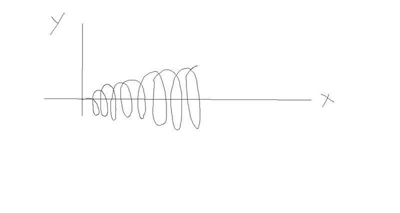

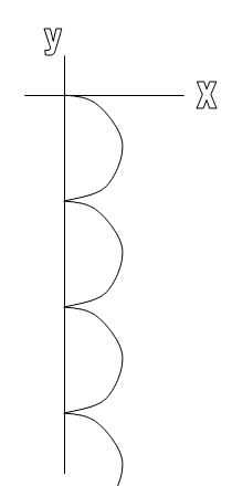

collinsmark said:
(Pardon my poor graphics by the way.) I haven't worked out the math, but this idea seems reasonable to me, even though I haven't backed it up. I was thinking something like this for q, E0 and B0 all being positive.
I really don't understand what kind of path the particle will follow. Is the path along the loops shown by your figure in X-Y plane or is it this way-
Where the path is spiral around the x-axis with the locus of centre of 'circles' on it.
Please prove which one is right.

I'm pretty sure it's the second one, since I see no reason why the average position should move away from the x-axis.
But if you want it proved … try it yourself! :smile:

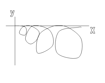

Actually, now I think we were all wrong. Doh! :eek: :redface:
Upon thinking about it further, the patter might actually look like this for q, E0 and B0 all being positive. (To make it match the data given in the problem statement, flip it up to the positive y-axis by making B0 negative, or by making both q and E0 negative.)
https://www.physicsforums.com/attachment.php?attachmentid=30367&stc=1&d=1291498687
This shape is a consequence of the velocity starting out at zero at the origin. The shape would be quite different if the initial velocity was non-zero.
My logic is this. The particle will accelerate along the x-axis, skewed along the y-axis until it reaches some maximum velocity. At this point the magnetic force is greater than the electric force, so it still accelerates in the negative x direction. 'Same thing as saying it "decelerates." As it goes more negative in the x-direction, toward the y-axis, the velocity slows. But there is some symmetry here. The particle's slowing down in the second half of the first hump is symmetric to it speeding up in the first half of the first hump.
But I think what we all forgot before was that the first half of the first hump is symmetrical to the second half of the first hump. The end result is a repeating pattern along the y-axis. It will go positive or negative along the y-axis depending on the signs of q, E0 and B0.
That mistake corrected (well, sort of. I haven't proved anything yet), I still claim, that the particle will be restricted to one quadrant.
I have to run some errands, so I can't prove this right now, but I might be able to get back to it later. In the mean time, I offer you this simulation that corroborates what I'm saying:

Just so we're all on the same page my attached drawing (the newer one) figure mysteriously disappeared somehow that goes with my last post. I'll attach it again here for reference.

Yes, the shapes can vary quite a bit depending on the strengths. :smile: My only real points are as follows.
  • Given the way the problem statement was phrased, the particle is confined to one quadrant. And which quadrant that is depends on the signs of q, E0 and B0. Since the problem statement implies a positive y position, it means that at least one of the numerical values for q, E0 and/or B0 is negative.
  • Isn't it nice that we have the work-energy theorem. Using the work-energy theorem, we found a rather simple solution to the problem statement that would have otherwise have been very complicated.
hi collinsmark! :wink:
thanks for the useful link and the correction! :smile:
clearly my instinct was completely wrong …
the "drift" is in the y direction not the x direction :rolleyes:
here's a simple proof of why:
if E < cB, put r' = r - (E/B)tj
then v' = v - (E/B)j,
so dv'/dt = dv/dt = (q/m)(Ei - Bv x k)
= (q/m)(Bv' x k) …
in other words, in a frame of reference moving at speed E/B in the y-direction, the electromagnetic field becomes a pure magnetic field of strength B
(we could deduce the same … apart from a "relativistic" correction … from the standard transformation equations, see http://en.wikipedia.org/wiki/Mathem...formation_of_fields_in_vector_field_approach")
and since the initial velocity in that frame is E/B in the negative y-direction, the particle moves at that constant speed round a stationary circle of radius mE/qB2, exactly as if it were on the rim of a stationary wheel touching the y-axis
so in the original frame of reference, the particle moves exactly as if it were on the rim of a wheel rolling along the y-axis at speed E/B, ie a cycloid! :smile:
surprisingly, this is exactly the same motion as that of a bead fixed to a weightless circular wire stuck in a groove on the ceiling but free to roll along it …
the bead feels a constant vertical force, mg (equivalent to E),
and if you do all the maths (there must be a simple way of doing it, but I can't see one :redface:), you find that the angular speed of the wire is a constant, √(g/r), and that, in addition to mg, there is a force, 2sin(θ/2)mg (equivalent to B), directed towards the instantaneous centre of rotation at the top of the circle and proportional to the instantaneous speed, 2sin(θ/2)√(gr) !​
