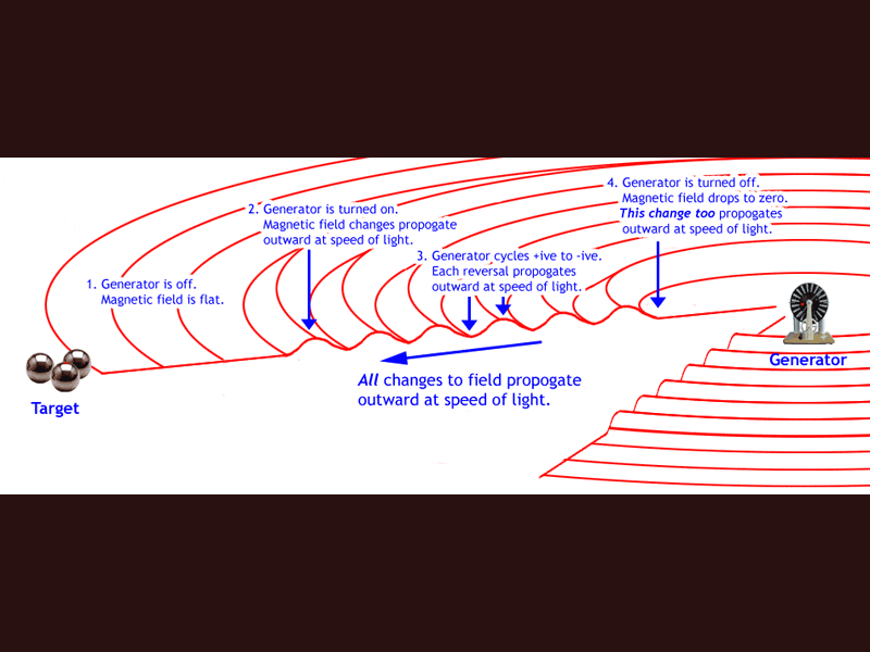

Thank you for the reply. Without the involved math, I am handicapped. Nevertheless, given that the current goes from some value to zero via a complex path, my original question can be modified a bit to fit. Does the magnetic field (in concert with the changing current) go to zero simultaneously close to and far away from the wire, or does it go to zero close to the wire first, or does it go to zero furthest from the wire first?
I have a diagram for that too.
I had the impression that for a pure induction field, it can collapse instantly without a propagation delay. So the same must be true when it is built. For example, the magnetic field of a solenoid fills the Universe, yet it can discharge in a microsecond.
For two circuits coupled together by an induction field, as in a transformer for instance, we do not so far as I know experience a propagation delay. The two circuits operate as one.

If that were true, it would be an instant communication device.
The speed of light is effectively instant over short ranges. But mind that word 'effectively'.
Electromagnetism propagates at the speed of light.
These statements are not correct. Maxwell's equations are very clear on what happens. All changes to the fields propagate at the speed of light, as DaveC's diagram shows.

tech99 said:
If we have a solenoid carrying a current, its magnetic field extends outwards without limit. The magnetic field stores the inductive energy.
Only if it has been carrying the same current for infinite time. Fields propagate in a vacuum at the speed of light.
If you have a 10 cm wide transformer, the propagation delay is about 20 picoseconds. It is real, but I doubt if you would notice it.
