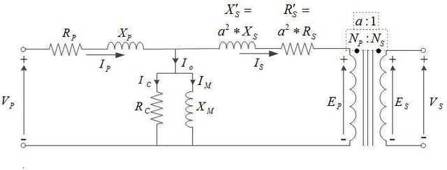

Modeling (simulation) of physical systems is a two-step process. Step 1 is writing the equations that represent the physics. Step 2 is solving those equations. CA is the step 2 part of the process. It is a purely mathematical process, divorced from physics. The CA tools mentioned above are mathematical tools. Analysts are thus better off focusing on the analysis task and ignoring the physics.
It is tempting to think that idealized components (R, L, C, V, I, diode, transformer) are merely simplified versions of the real things. For example, an L is just an inductor where we neglect any resistance and parasitic capacitance it has in real life. But at the CA stage, we focus on the analysis. For example, in CA L is simply a ##\frac{dI}{dt}## term, nothing more.
It is common practice to model real-life components using equivalent circuits of ideal components. For example, a real-life transformer violates the assumptions of CA, but the transformer equivalent circuit below (which includes an ideal transformer) complies with CA assumptions.
