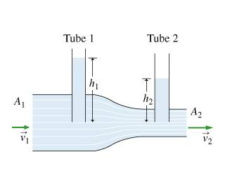

1.
Find , the speed of the fluid in the left end of the main pipe.
Express your answer in terms of h_1, h_2 , g , A_1, A_2.
2. Bernoulli and continuity equations
3.
p_1 = rho*gh_1
p_2 = rho*gh_2
p_2 = p_1 + 0.5rho*v_1^2 + 0.5rho*(A_1/A_2)^2 * v_1^2
I know those are correct.
Substituting for p_1 and p_2, and solving for v_1 I obtain:
2g(h_2 - h_1) / [1-(A_1/A_2)]
all that under a square root.
No idea why I am getting it wrong. Should h_2 - h_1 just be h??
Yeah, I am totally stuck on this one. Solving for V_1 I get the following, and I don't see where I could have made a mistake:
v_1 = sqrt[2g(h_2 - h_1) / (1-(A_1/A_2))]
:D this question had me stumped for a bit but ur equations helped a bit ... sort of >.>
kk First i got my own equations xD lol
Q=v1A1=v2A2
from this we get that v2=(v1A1)/A2
P1-P2=\rho/2* (v2-v1)
Now sub in v1 for v2
this gives us
P1-P2=\rho/2* ((v1A1)/A2-v1)
Now do a little math ... >.> well maybe not a little
but you'll get that v1=
sqrt( (g(h1-h2)) / ((A1/A2)^2-1))
o.o' wish i knew how to code that up so it would look pretty
but the only difference between this and your answer is in the demoninator
first off the A1/A2 part is supposed to be squared
and ur signs are backwards :D hope this helps ^^
