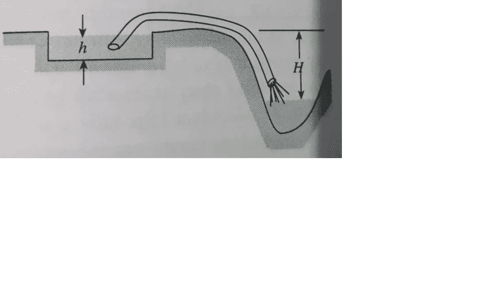

A person wants to move all the water from pool (on the left side) to a container (on the right side). He uses pipe with cross sectional area 5 cm square. If h = 2 m and H = 20 m, what is the time needed? Take the area of the pool 50 m square
Bernoulli equation
Flow rate
I take position 1 as the surface of the pool and position 2 as the surface of the container so the value of ##P_1 = P_2 = P_{atm}## and ##v_1=0## and ##h_2=0##
##P_1 + \rho gh_1 + \frac{1}{2} \rho {v_1}^2 = P_2 + \rho gh_2 + \frac{1}{2} \rho {v_2}^2##
##\rho gH = \frac{1}{2} \rho {v_2}^2##
##{v_2}## = 20 m/sThen, ##\frac{\text {volume of water in pool}}{\text {time}} = \text {area of pipe} . {v_2}##
I get time = 10 000 seconds but the answer key is 600 seconds
Where is my mistake? Thanks
Two mistakes.
A mistake In conversion of units (I'm guessing) led to 10000 instead of 100.
The other mistake is that you assumed the height difference is constant.
But there is a flaw in the question. You are not given the cross sectional area of the container on the right. That would be ok if it were very wide, but it does not appear to be. Maybe assume it is very deep into the page.

Whoops, you are right.
But there is a mistake I missed. What is atmospheric pressure, and why is that important here?
In view of this, I withdraw my charge that the question is flawed. The correct answer is about 64000 seconds.

Did you create this sketch yourself?
Please, see:
https://en.m.wikipedia.org/wiki/Siphon
The text of the problem does not specify the way in which the water flows.
"A person wants to move all the water from pool (on the left side) to a container (on the right side). He uses pipe with cross sectional area 5 cm square."
No, I post the original question
This is really helpful. I do not know this set up is called siphon
The person wants to move the water from pool (on left side) to container (on right side) so the water will flow from left side to right side

Sorry I am still not sure if I understand how this set up works.
1. Shouldn't I need to consider how deep the pipe in the pool on the left side? In this question, I just ignore it because the question did not give the information and I just assume the pipe is at the top of the water surface of the pool?
2. The pressure at the end of the pipe in the pool is higher than the top part of the pipe so the pressure will push the water to flow in the pipe?
3. After reaching the top part of the pipe, the water will flow down due to gravity.
4. Will the water turn to gas when it moves to the top of the pipe due to the pressure at the top of the pipe being zero?
Thanks
Yes, you do need to consider the depth of water in the pool. Since this varies, you need to get a differential equation relating the depth to the rate of flow.
The depth to which the hose goes in the pool doesn’t matter as long as it is always below the surface. Take it as always being at the bottom of the pool.

So I need to set up bernoulli equation for point 1 (which is at the bottom of the pool) and point 2 (which is at the surface of the container).
The depth of water in the pool will decrease to it will affect the value of ##P_1## (because ##P_1= P_{\text{atm}}+ \rho gh## and the value of ##h## is not constant)and also for ##P_2## to be always equal to ##P_{atm}## I need to consider the rate of increase of water level in the container?
No. As we have established, there is not a continuous stream of water between those two points, so you cannot apply Bernoulli between them.
You know the pressure at the apex of the tube.

So I take position 1 as the left end pipe in the pool and position 2 as the apex of the tube.
##P_1+ \frac{1}{2} \rho {{v_1}}^2 + \rho gh_1=P_2 + \frac{1}{2} \rho{{v_2}}^2 + \rho gh_2##
##P_{\text{atm}}+\rho gh+ \frac{1}{2} \rho {{v_1}}^2 + \rho g(H-h)=P_2 + \frac{1}{2} \rho{{v_2}}^2 + \rho gH##
##h## is function of time , ##P_2=0##
Can I take ##v_1## as 0?

songoku said:
$$\rho g(H-h)$$
What does this term represent in the physical picture?
Do we actually have a continuous stream of water of density ##\rho## in the downstream side of the pipe?
##H-h## is the height of the left end of the pipe (the one in the bottom of the pool) measured with respect to the container
I am not setting equation for the downstream side of the pipe. I am setting up bernoulli equation for the leftmost end of the pipe (in the bottom of the pool, I set this as position 1) and the apex of the pipe (as position 2)
Thanks
I am not getting it. If you are considering the left hand portion of the pipe then the right hand side and, in particular, ##H##, is irrelevant.
@haruspex has provided a big hint. You know the pressure at the apex.
Thanks
Much better.
Yes, v1=0.
But on the left you have both ρgh and ρg(H-h), which makes no sense because that would reduce to ρgH, canceling the term on the right.
Next, you need an equation relating h to v2.
haruspex said:
Much better.
Yes, v1=0.
Let me try again
##P_1+\frac{1}{2} \rho {v_1}^2 + \rho gh_1 = P_2 + \frac{1}{2} \rho {v_2}^2 + \rho gh_2##
Taking the bottom of the pool as reference, ##h_1=0## and ##h_2=h##
##P_{\text{atm}} + \rho gh'= \frac{1}{2} \rho {v_2}^2 + \rho gh##, where ##h'## is the depth of water in the pool
For equation relating ##h'## to ##v_2##:
##\frac{d \text{(volume)}}{dt}=-a.v_2## where ##a## is area of pipe and the negative sign because the volume is decreasing
##A.\frac{dh'}{dt}=-a.v_2## , where ##A## is area of poolI need to use integration?
##\int dh'=-\frac{a}{A} .v_2 \int dt##
##h'=-k.v_2.t+c## , where ##k=\frac{a}{A}##
Taking ##h'=h## when ##t=0##, I get:
##h'=-k.v_2.t+h##
So:
##P_{\text{atm}} + \rho g(-k.v_2.t+h)=\frac{1}{2} \rho {v_2}^2 + \rho gh##The term ##\rho gh## will cancel out?
##P_{\text{atm}} - \rho gk.v_2.t=\frac{1}{2} \rho {v_2}^2##To move all the water to the apex of the tube ##\rightarrow h'=0##
##h'=-k.v_2.t+h##
##t=\frac{h}{k.v_2}##Then:
##P_{\text{atm}} - \rho gk.v_2 \frac{h}{k.v_2}=\frac{1}{2} \rho {v_2}^2##
##P_{\text{atm}} - \rho gh=\frac{1}{2} \rho {v_2}^2##Is this even correct? Thanks
