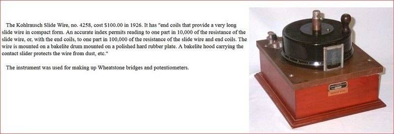

Aha ! The significance of zero once again !Take yourself back a hundred years to the days before precision electronic amplifiers and voltmeters.
How could you measure something accurately?
This link has pictures of some 1920's lab equipment.
http://physics.kenyon.edu/EarlyApparatus/Electrical_Measurements/Kenyon/Kenyon.html

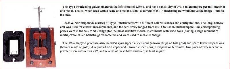

Small currents were measured with galvanometers that instead of a needle had a small mirror - a beam of light reflected onto a wall several yards away gave tremendous movement for small current. That's amplification without electronics...
They had good enough wire to make resistors that matched well. Manganin was popular because of its near zero temperature coefficient.
So they could make accurate voltage dividers.
A popular local voltage reference was the weston Standard Cell, a small battery sealed in glass. It produced a constant voltage so long as you didn't ask any current of it.
Small voltages were measured by a Wheatstone bridge.
When balanced , the bridge produces zero voltage as Let'sthink observed.
With primitive equipment it's easy to accurately measure zero voltage because there's no deflection on the galvanometer. But it's difficult to measure the value of any other voltage.
That's the significance of zero.
With the simple tools of just an accurate slidewire, a standard cell and a sensitive zero detecting galvanometer , one can make a Wheatstone bridge that'll measure accurately the millivolts from a thermocouple. We used them well into the 1970's. The user balances the bridge manually by turning a big knob that rotates the slidewire .

We actually had these in the school labs .
That's a true thing of Beauty !might be of help to @msarker in his thread 'measuring low Elecromagnetic field'
