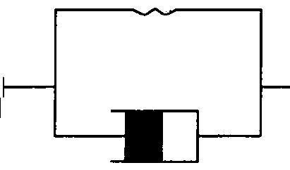

VooDoo Messages 58 Reaction score 0 Thread starter Oct 29, 2009 #1 Hey guys, I was just wanting to know, if there is a special way to add a damper in spring in parallel (as per the image below). i know that springs in parallel is; 1/k(total) = 1/k1 + 1/k2... Attachments system.jpg 4 KB · Views: 728
nasu Homework Helper Messages 4,474 Reaction score 923 Oct 30, 2009 #2 Put the spring in a viscous medium. Actually any real spring is a little bit like that.
Bob S Messages 4,662 Reaction score 8 Oct 30, 2009 #3 See section on damped harmonic oscillator in http://en.wikipedia.org/wiki/Harmonic_oscillator Bob S
Barkan Messages 19 Reaction score 0 Jun 3, 2011 #4 spring coeff: k damper coeff: c total impedance is k + sc in laplace domain
