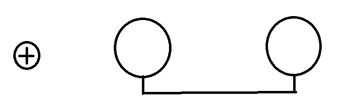

This is a question that is vaguely related to coursework but is more for curiosity.
Lets say there are two spheres joined by a thin wire in the presence of an electric field:
Assume the conductors initially have no charge. Now I am pretty sure without the wire, the charge distribution would look something like this:
But for the life of me I cannot figure out how it is spread when they are joined by a wire because I am not sure how having the same potential would affect their charge distributions. Any help on this would be appreciated.

A key question is whether you can ignore the field at each sphere that arises from the charges on the other sphere. If you cannot then even with no external field (the + charge on the left in the diagram at the start of this thread) this is quite a tricky problem. See https://arxiv.org/pdf/0906.1617.pdf.
If you can ignore the interaction of the fields from the spheres, you can treat each sphere independently as a charged conducting sphere immersed in a uniform field (parallel plates, say) and find its potential as a function of charge and radius. Then set the two potentials as equal.

The two spheres are not in the same potential BEFORE we attach the wire. The left sphere that is closest to the source charge + has higher potential ##C_1## than the right sphere ##C_2##.
When we connect the wire the surface charges redistribute so that the potential becomes everywhere (on the conducting structure consisting of the spheres and the wire) the same C, ##C_2<C<C_1##. We can easily understand why this happens if we view the structure as a unified conducting object. However I admit if we see the structure in sequential steps our intuition is bugging.

I may be wrong, but I think T.Centa is asking how to compute the new charge distribution.
Yes I guess so now that I read OP again.
