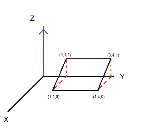

How Does Coil Orientation Affect Mutual Inductance Calculation?
niggchao
A rectangular coil is composed of 150 turns of a filamentary conductor. Find the mutual inductance in
free space between this coil and an infinite straight filament on the z axis if the four corners of the coil
are located at
B = (phi-hat) μoI/2πr
dS = (n-hat) dydz
[/B]
Φ = ∫B⋅dS
I can easily solve this problem if the coil is parallel to the y-z plane and x = 1 since the r in the formula varies only on y thus, becomes sqrt(y2 + 1) then convert phi-hat to cartesian unit vectors and the area unit vector is just -(x-hat).
Now, in this problem, I have converted the area unit vector to its cartesian unit vector. I am confused on how I will write the expression for r since it now varies on x, y, and z?
What relates polar (r, θ) to cartesian coordinates x and y? r is not a function of z.
and http://www4f.wolframalpha.com/Calculate/MSP/MSP6082070f83052eaehe200002h13c1i6iciah25i?MSPStoreType=image/gif&s=40&w=93.&h=28. then
B = (-
sinφ +
cosφ) μoI/2π*sqrt(x2+y2)
dS = (-[PLAIN]https://upload.wikimedia.org/math/8/7/5/875326710761d5ed42bdc6e30c4bf962.pngcos45 - [PLAIN]https://upload.wikimedia.org/math/8/b/a/8baf9dc7043aae61e37e171dc9f537e9.pngsin45) dydx I changed it from dydz to dydx because my variables in the integral are x and y. Is this okay?
Then integrate the dot product to get the flux.
What do you think?

I think you're off to a great start!
B = (-
sinφ +
cosφ) μoI/2π*sqrt(x2+y2),
what are cosφ and sinφ in terms of x and y?

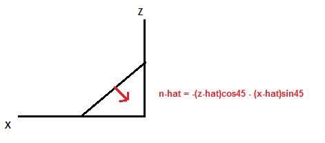

dS = (-[PLAIN]https://upload.wikimedia.org/math/8/7/5/875326710761d5ed42bdc6e30c4bf962.pngcos45 - [PLAIN]https://upload.wikimedia.org/math/8/b/a/8baf9dc7043aae61e37e171dc9f537e9.pngsin45) dydx is almost right. This is the tricky part. Your area element is dy times the differential distance along the sloping area. Call it dζ. So your differential area is dydζ.
Can you see that dζ2 = dx2 + dz2 ? But you can eliminate dz; what is it in terms of dx? Your differential area can then be (constant)*dxdy, multiplied by the normalized normal vector S. To check that you got the right constant, just integrate (constant)*∫∫dy dx over the limits given you. You know the area has to come out to 3√2.
The rest is as you say. Don't forget N = 150 and mutual inductance is a positive number.
Not really sure if I understood the dS part but I'll try
cos45 = dx/dζ
dζ = dx/cos45
dS = (1/cos45) dxdy
dS = (-[PLAIN]https://upload.wikimedia.org/math/8/7/5/875326710761d5ed42bdc6e30c4bf962.pngcos45 - [PLAIN]https://upload.wikimedia.org/math/8/b/a/8baf9dc7043aae61e37e171dc9f537e9.pngsin45) (1/cos45) dxdy
I did integrate dS and got 3√2 but I'm afraid this might be a coincidence. What do you think?
which if you'll permit me = - k - i :smile:
I think it's no coincidence. I think you're banging at the door.
So now, proceed to do the integration? A word of warning: there are of course two ways to do the double integration over x and y. You will be appalled at how messy the closed-form results are either way. BUT - if you do what I did and let wolfram alpha do the definite integrals you happily get the same numerical answer either way, as of course you should. So if you get an answer we can compare notes.
