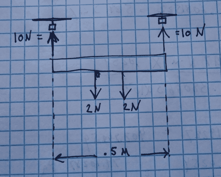

Hello all,
I'm trying to understand the maximum moment on a free beam. Consider a tail sitter drone that is simplified into being a beam with two motors fitted with propellers on the end of the beam (see the photo below), let the payload be estimated as two, 2 newton loads going downwards. If the drone is at rest, and its motors are suddenly turned to the highest thrust they can output (10 N), what is the maximum moment experienced on the beam and what is its location? Consider the weight of the beam and the motors to be zero.
Each square on the paper is equivalent to a length of 6.25 cm.
To solve this, I consider half of the beam to be a cantilever beam fixed at one end, the maximum moment then becomes:
Mnet = 10N x 0.25m - (2N x 0.0625m) = 2.375 N-m at the root of the imagined cantilever beam, and directly in the middle of the entire real beam.
My question is, is this correct? I just feel like something is wrong here since it is a free beam. Would things change at all if the motors revved up to 10 N slowly instead of instantaneously, and what if it gained velocity in the direction of the motor's thrust before the motors reached 10 N?
Any insight would BE MUCH APPRECIATED.

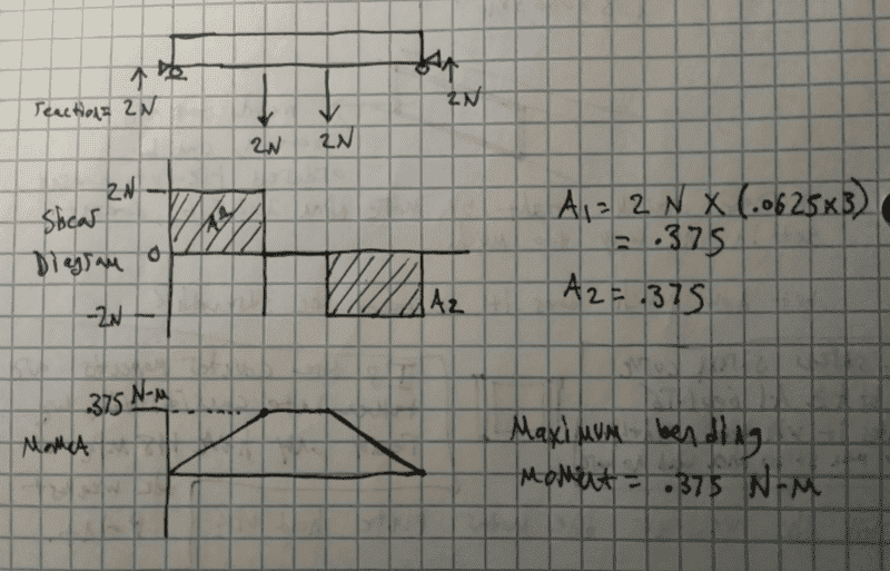

For a static analysis, turn the problem upside down.
Ignore the 10 N end forces, replace them with a fulcrum and a roller.
You then load the beam with 2 N at two points.
Sketch a moment diagram for each of the loads. Sum the two.
The maximum moment will be constant in the middle of the beam, between the two load points.

Like this? But why doesn't the 10 N on both sides play a role?
Because the forces are unbalanced, so will accelerate the beam upwards.
You have loaded a weightless beam with forces.
There is no mass to have inertia.
That makes so much SENSE!!! THANK YOU, but was my calculation procedure correct?

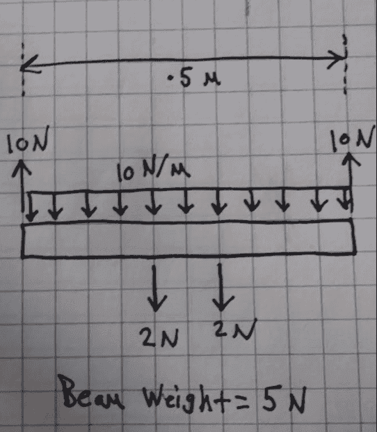

Me and Susan sure do disagree, the only answers I find interesting are the ones that answer my question.
Indeed I am trying to design an airframe that must withstand dynamic loads, so this isn't an equilibrium problem, but a dynamic one I suppose.
Here I've added the force of the weight of the beam and the length, If we ignore air resistance and the torque of the motors spinning, then this should be all the forces on the beam. Any idea where to take this in calculating the maximum moment?
To be honest, no.
You will get a correct and obvious answer, once you find the right question. Indeed, given the right question, you would have answered it yourself. In effect, we are searching for that right question, the one that will have the right answer. Susan Sontag is also seeking the right question, and appreciates every clue.

Addressing the flight effects on your calculation. The size of your UAV is small but these are some items you need to consider.
You're missing torsional considerations in that beam design. Baluncore put it correctly when he/she said "For a static analysis". The loading on that beam will never be uniform. All flight needs multilateral attitude adjustments. You're treating the rotor lift and load as static. It's not.
Also, a fixed two rotor aircraft will only go up and down. You need to add yaw & pitch devices to the two motors or at least three opposing motors to control attitude.
Your velocity assumption is a required. Acceleration and deceleration need to be considered. Rotor acceleration has a bounce effect in the loads momentum. If load momentum exceeds the aircraft's momentum when reaching an equilibrium in lift; the rotors flight ability stalls. This has zero effect on your arm design and is more concern in flight controls.
Helicopters get the load off the ground by slowly meeting the loads lift requirement and then proceed with transitional lift. The loads wind resistance keeps it taught and within reasonable control in transitional lift and flight. Vertical lift 'only' will cause flight problems.
