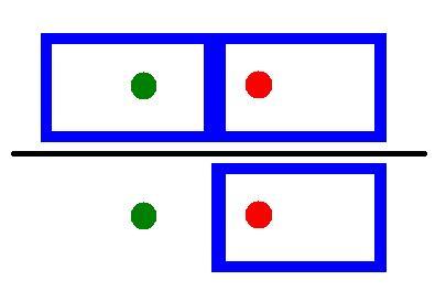

I had a question regarding how Gauss's law works. I have attached an image that depicts two scenarios.
Basically, if you assume the blue lines are a conductor and the green and red dots both contain an equal amount of charge, what is the expected behavior of the red dot?
As I understand it, in the lower scenario, Gauss's law allows the blue conductor to shield the red dot from the green dot; thus, nothing happens to the red dot. What happens in the second scenario? (The one I drew above) Does the red dot remain where it is or move away -- and please explain why..

What happens is that, the charge distributes in such a way so that the electric field due to the induced charges on the inner surface of the conductor cancels exactly with the field due to the charge inside the cavity, at all points in the conductor.
So, the two charges inside the cavity won't expereince the field of each other and won't move.

In the lower scenario the field from the green dot affects the charge distribution on the outer surface of the conductor, but the conductor itself shields the red dot from being affected by the field of the green dot.
In the upper scenario both dots are shielded from each other. Neither dot is affected by the presence of the other.
