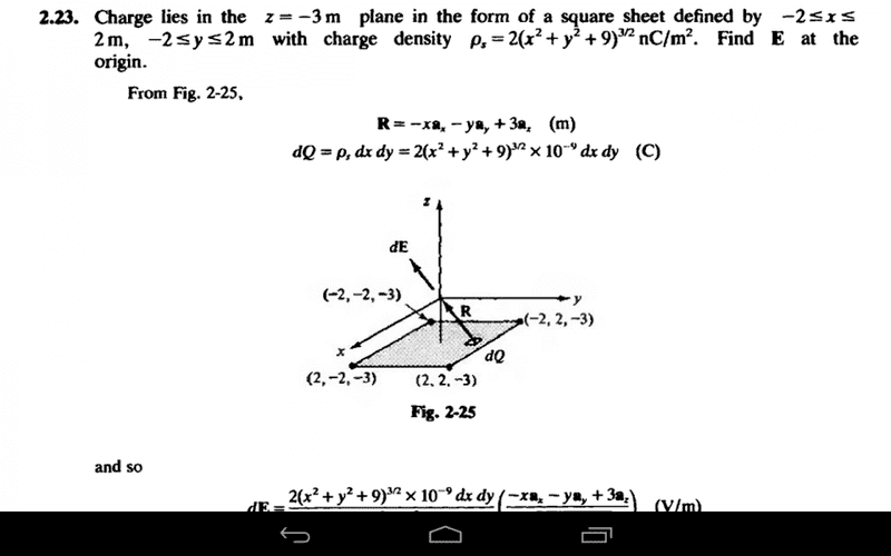

From attachment R=-xaa-yay+3az
I see 4 different values, one for each quadrant.
1st.quadrant
R=+xaa-yay+3az
2nd. quadrant
R=-xaa+yay+3az
3rd.
R=-xaa+yay+3az
4th
R=-xaa-yay+3az
Where did I go wrong in determine value of R?

The equation they gave applies to all 4 quadrants. It is just equal to minus a position vector drawn from the origin to any arbitrary point (x,y,-3) on the square sheet. The 3 unit vectors in their equation are pointing in the 3 positive coordinate directions.
