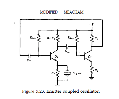

Hello folks,
I've been trying to understand how crystals work in crystal oscillator circuits. I understand the piezoelectric effect to the following extent: If we apply an electric field to the crystal it will deform and when the field is removed, the crystal will generate an electric field in the opposite direction. I get stuck at the point where the electric field is removed. I can't seem to understand how the electric field is removed in crystal oscillator circuits. I've attached a diagram of a crystal oscillator circuit. I'm looking for a qualitative analysis of the circuit without using the RLC model of a crystal. I'm trying to understand what exactly happens to the crystal during oscillation. What I'm looking for in terms of an analysis, is an explanation similar to the following one: base voltage of Q1 increases, which increases voltage at the emitter which increases current through R1, etc, etc, etc, around the loop.
Thanks.

A crystal is an insulator so it can be operated with a permanent bias voltage.
The electric field is not really removed, it is cyclically reversed about the average bias point.
The key to the oscillation is the capacitor. When you apply power to the circuit, current flows into the base of Q1 which causes V(Q1c) to drop. The rate of change of that voltage is what passes through the capacitor, not the voltage itself. Eventually the voltage at Q1c stops dropping and at that point the base of Q2 stops seeing the negative voltage from the capacitor. V(Q2c) now starts to fall, lowering V(Q1b), lowering the voltage across the crystal and raising V(Q1c) which causes V(Q2c) to increase even more.
With the crystal in the emitter, the gain of the stage goes to a maximum at the series resonance frequency so the (positive) feedback C supports the oscillation.
For an even more generic analysis... think of the crystal as a freq-variable emitter degeneration resistor. At the crystal freq, it permits (ac) current flow, at all other frequencies it presents a high impedance and through negative feedback (emitter degeneration) it blocks Q1 from amplifying.
The point about a crystal is that it has an extremely narrow frequency band where the impedance goes very low. At other frequencies (+/- 0.0001%) it looks like either a very small Capacitor or a very large Inductor. (This is just another way of saying it has a very narrow resonance bandwidth.)

Reading that through again, I think it's the wrong way round. The gain of the first stage is -0.8 off resonance as the crystal is high impedance and the emitter resistor is R1. It then goes to whatever β let's it be, at resonance.
Correct. The frequency of oscillation will not be at the crystal's resonant frequency because at resonance the crystal impedance will be a maximum, so circuit gain will be a minimum. The oscillation frequency will therefore be offset slightly onto the shoulder of the resonance where the crystal behaves more like a phase shifting trap. For that reason this design of oscillator will not be frequency stable.

Crystals have two resonances - series and parallel. I know that oscillator circuits can be confusing (and it's been a long time. . . . .) but why do you assume the crystal is operating in its parallel mode? The maximum gain will be when the resonance is series and the emitter load is nearly zero. I am not arguing - just asking.

I went through this exact process but had difficulty seeing how it would BEGIN oscillating. The moment when power is applied, what exactly happens to the crystal? (i.e. Does it begin deforming? Does it fight back with an opposite E field?)
Sophiecentaur; Voltage gain is not the only criteria. Phase is also important. A crystal in that circuit is most unlikely to ever operate at either it's parallel or it's series resonant frequency. It will slide to some operating point part way between the two, hence the poor frequency stability.

I take your point about the crystal. I will stop worrying about it. Suffice to say that the open loop gain is small in magnitude and there will be a frequency for which the phase around the loop is right to make it oscillate. Unlike in a 'proper' crystal oscillator, the feedback capacitor value becomes more relevant than the presence of the crystal might suggest.

The circuit in the OP is from; CRYSTAL OSCILLATOR CIRCUITS. Revised Edition, 1992, by Robert J. Matthys.
The title "MODIFIED MEACHAM" on the diagram refers to discussion of a different design beginning at the bottom of page 53.
The text on page 53 that accompanies the diagram reads as follows:
R J Matthys said:
5.10. EMITTER COUPLED
The emitter coupled oscillator is a series-resonant circuit, and a basic schematic is shown in Fig. 5.23. The oscillator has a positive feedback amplifier with a loop gain of slightly less than one without the crystal, so that the circuit will not oscillate by itself. Loop gain is controlled by the ratio of the collector to emitter resistances in each transistor stage. In the second stage, it is convenient to make emitter and collector resistances (R2 and R2) equal to each other, giving a stage gain of 1X. The second stage inverts the signal and provides positive feedback.
In the first stage, the collector resistor 0.8R, is made a little smaller than the emitter resistor R1 in order to give an overall loop gain of 0.8X. The value of the emitter resistor R1 is set equal to about twice the crystal’s internal series resistance R,. When the crystal is tied in parallel with R,, the effective resistance of the emitter resistor is reduced at series resonance, since the crystal’s internal resistance R, is in parallel with R1. This raises both stage gain and overall loop gain to about 2X, and the circuit oscillates at the crystal’s series-resonant frequency.
An advantage of this circuit is that the crystal sees a very low resistance load. This low resistance load consists mostly of the emitter’s input resistance, which is much lower than RI. A disadvantage is that circuit waveforms vary with the circuit’s stray capacitance, because loop gain is almost high enough to oscillate at any frequency.
