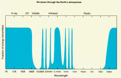

What if we consider high frequency EM waves like gamma and X rays will they undergo significant diffraction due to these molecules ?
They get more than just diffracted. The following graphic shows atmospheric absorption across the EM spectrum.
Visible: Yes. Ultraviolet: A little. X-ray: No.
