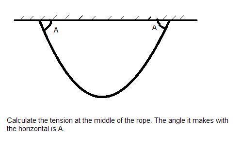

How do I calculate the tension at the middle of a rope (weight=W) suspended at two points as a catenary? It's ends make angle A with the horizontal.
What have you tried thus far?
