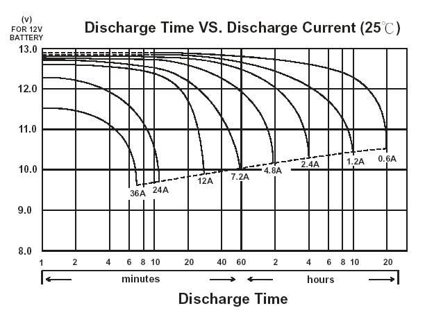

The discharge current level affects the decay of the output voltage with respect to time. Depending on the discharge current, the battery can last for a short time or a long time. Keep in mind that using large discharge current levels is a bit wasteful, since you are pulling that large current through the series resistance of the battery, and heating up that resistance is wasteful of the battery's energy.
Have a look at a typical set of discharge curves to help you understand:
http://www.steveduncan.net/assets/images/mfg_curves.jpg
The dotted line is where pretty much all of the useful energy stored in the battery has been pulled out (time to recharge...).
A battery stores its rated energy, which in watt-hours is (nominal volts) X (rated amp hours) watt-hours.
Berkeman's post shows that the rate at which you withdraw that energy affects how much of it you actually get.
Battery specifications tell you at what rate you should discharge the battery to get it all. Car batteries are typically rated in amp-hours for eight hour rate, that is connected to a load that'll pull the energy out over an eight hour period. Take its amp-hours and divide by eight to figure that load in amperes. At higher load you'll get less energy out, at lower load you'll get a little more.
Smaller batteries like for flashlights or radios may be rated at other discharge rates.

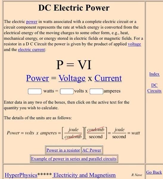

I was taught the equation for calculating energy lost due to resistance was: P= I^2 • R
You were probably taught that the Power is I2R.
There is an important distinction between Energy and Power. (This is what the thread is about)
Also, as I wrote earlier, the value of internal R is not necessarily the same for all currents.
My bad. The equation I entered above for power (Energy/Time) lost due to resistance in electrical circuits is as I stated. I was commenting on the conversation as it was progressing. I did not realize I was not allowed to follow along since resistive losses were being discussed. I was trying to provide an formula to assist the originator of this thread as they had asked. I would like to suggest a site that they might find helpful. I found the following at Hyperphysics:
I think that will help To answer this question:
What about the formula best to calculate the output energy from the battery converted to heat?
