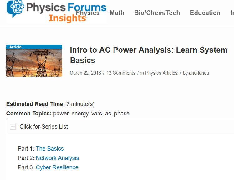

BTW, there is a good set of PF Insights articles about the power grid:
https://www.physicsforums.com/insights/ac-power-analysis-part-1-basics/#toggle-id-1
See also-for instance:
