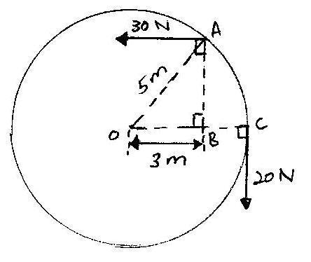

I understand that to find moment of force, we look at direction of force and perpendicular distance. In the diagram, O is the centre and pivot of the circular disc.
Would the anticlockwise moment at A be (30N x 4m)? I'm not sure if this is true, cos the distance 4m is only AB. It does not include O which is the pivot.
Should we resort to resolving the 30N force to 2 components at 5m (OA)?
(Clockwise moment is straightforward here, isn't it?)
  • Diagram of a circular disc with centre O, showing a 30 N force pointing left at point A on the rim, a 20 N force pointing down at point C, radius OA labelled 5 m, and OB labelled 3 m along a horizontal line through O.
Yes.
What counts is the perpendicular distance from the line of the force to the pivot, which equals AB.
That's a perfectly fine thing to do. Try it and you'll see that you get the same answer for the moment, since OA*F*sinθ = AB*F.
Sure.
