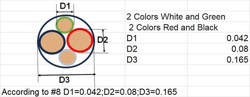

custom wire:
BN222216FEPUPU
22(7x12/44) 155 Strands Tin plated copper wire
0.032 Wire diameter
0.005 Inch FEP insulation
Wire O.D 0.042 Inch
2 Colors White and Green
16(7x38/40) TC
0.010 FEP Insulation
0.080 OD
Color Red and Black
Twisted together with 1.0 inch Left Hand lay
Core O.D 0.165 Inch Pressure Extrude
Final Jacket Black Polyurethane
I can measure currents resistively and using hall effect devices. I can dynamically watch currents of over 100A. I can apply loads of over 50A. I have tested over 20 of the charger supplies and verified that they will not supply over 10A continuously. At times I have seen in our system the batteries spike to 60A momentarily. On both sides of the hot spot there are 20A fuses. Fuse's are guaranteed to blow in less than 1 minute at 250% rating. I did verify this by putting on a 40A load and it blew fairly fast.
Now back to my problem. I have customers sending back melted chargers. I can't reproduce the problem. The highest temp that I see is 33.7C, but I see parts that have damage that needs 80C in one case and 200C in another. This wire case is the 200C instance. So the question is how much current would be needed on that wire to get these temperatures.
Then I will need to take a 400th look at the system and theorize how the heck to get this given the charging system / battery circuitry!
The hot wire is the 16awg red wire.

Sorry, I don’t see any 16 awg copper conductor. First, there are total 4 cables. No one is 16 awg [22*(7*12/44)=3.696 mm^2 and 16*(7*38/40)=20.8544 mm^2) and 16 awg it is 1.30-1.43 mm^2.
According to #8 D1=0.042; D2=0.08; D3=0.165
However, if we take at BN 22(7x12/44) 155 strands[ actually there are only 154]
one strand is 12*(44 awg) 4.3* 0.00200"=0.0086" diameter and 12*4=48 cmils
7 strands=3*0.0086=0.0258" diameter and 7*48=336 cmils
22 of 7 strands=5.8*0.0258"=0.14964" diameter and 22*336 =7392 cmils [7.392*0.5067=3.7455 mm^2)
In my opinion, it is about 11 awg.
The same calculation for TC cable gives 0.34875"diameter and 41.157 MCM
16 awg (solid) diameter 0.0508" and cross section area 2581 cmils

Referring to #15, if we take only the strands in the parentheses BN (7*12/44) and TC (7*38/40 ) then the diameters are match with D1 and D2. However, TC is indeed 16", but BN it could be 25. BN presents 30.87 ohm/1000 ft and TC 4.057 ohm/1000 ft at 20oC [DC]
ethompson said:
The only way would be the battery doing it, as it is the only thing capable of the required current. I just do not see how the load can happen in our dongle and then dissipater.
Is the battery discharged after this event? You said it yourself, the battery is the only thing capable of the required current. Go from there. I don't know why you insist on making this so difficult.
If the all 4 wires are in parallel and the maximum total current it is 57 A then in BN will be 3.3 A and in TC 25 A and the temperature of conductors will be 200 dgr.C
However, it is for single cable only.I don’t understand what is the number total
of the cables and what is the running system-cable tray or else.
