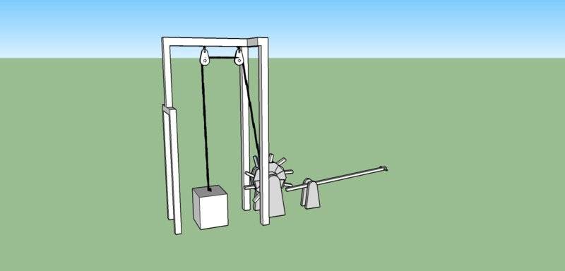

Hey, i don't know much about physics but i have heard that gravitational energy is non efficient since it needs a lot of power.
So this is what i had in plan..
Average household has 2 to 3 members with each waiting average 50 kilos.
You would use their combined weight force to pull up a 1000 kilo weight up in the air 5 meters using a 1:5 lever, two pulleys, wheel and a cabel.
About the force applied: 3 times 50 kilos if they stand on the lever, + they could use additional force pulling with their hands a rope that's tied to the ground.
The system i am talking about is down on the picture.
3D sketch of a gravity-driven device: a 1000 kg block hangs from a rope over two pulleys on a wooden frame, with the rope wrapped around a ratchet wheel that has paddle-like teeth, beside a long lever arm pivoting on a fulcrum.
About the wheel: The levers on the wheel can move in one direction letting the lever on which force is applied go down and pus the wheel again.
Whats the use?
So you have two small wind turbines.. two small solar collector.. And you are short of some extra power for your house to be fully independent.
Can someone brainstorm this quickly with me, or do the "calc"?

People are more efficient pedaling bicycle generators instead of pulling up weights. Maybe look at ways to store that energy (electrically in batteries or gravitationally with pumped water into a water tower).

Well, we can do a quick calculation to see...
75kg person rising up 0.25m each second is E = mgh, P = E/t
E = 100kg * 9.8m/s^2 * 0.25m = 184J/s, so Power = 184W. That's about the same as pedaling for a reasonable bike rider. I know which one I'd rather do for an hour straight... :smile:

We should get some actual figures from the original scenario. However you go about lifting the weight, you will require the same amount of Energy.
The work needed to lift 1000kg by 5m is 50kJ plus whatever losses there are in the mechanism - perhaps double that requirement. That's the maximum energy you could get back out (assuming everything is 100% efficient.
That would drive a 50W lamp for 1000seconds (17minutes) or a 5W lamp / radio / motor for 170 minutes or 2.8hours. Allowing for a realistic figure for overall efficiency, you could probably call it 2 hours. So that's the ball park figure for what the proposed system could give you back.
Bearing in mind that you would need to use electricity in order to make use of the mechanically stored energy then why not use a battery and a commercially available pedal power dynamo system?
Health and safety would need to be considered for the proposed system - use something that's intrinsically safe and off the shelf.

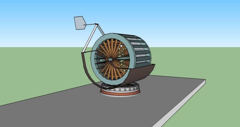

@sophiecentaur Its just gravitational battery, i was very disapointed when i found out its not efficient. Do you know anything about Compressed air energy storage?
I stumbled upon it couple minutes ago.
Its 99 % green.
Low cost.
Only takes up a lot of space.
But i am developing a system where i have a lot of sun, wind, water flow and a lot of space.
My main problem is the parts.
For sun i was planning on making two parabolic dish stirling generators, for wind, a vertical axis wind turbine with a blocker
3D sketch of a drum-shaped gravity or flywheel-style device with a wooden spoked wheel inside a teal rim, mounted on a circular base with a curved arm and a small flat panel on top, set on a grey platform.
And since i have a river by my house, i was planing on putting some water turbines inside.
For solar i have the satelite dishes and mirrors for free, for wind and water turbine i have a lot of motors and parts, and for compressed air battery i was planning to use old boilers and dig them underground, i just need to check the pressure.
So the problem is manufacturing stirlings, They are actually not that complicated, but i am not skilled in making.
There is other problem, with water, and insulating underwater generators.
About the compressed air battery, it actually wouldn't have to be so big, because we have 250 sunny days in croatia, a lot of wind and probably the river too.
So the compressor would be used as a backup, and for apliances that are being used over night when there is no sun and no wind.
How does it feel?
